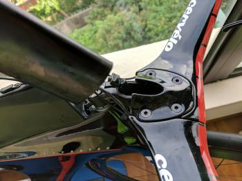

Tighten the bolt with a torque wrench according to spec (8nm).
All I did was
  1. loosen the bolt slightly (2 turns?)
  2. took riser post out
  3. replace post and tighten up to 8nm
Then I saw this!
Now no part to replace and the clamp is stuck inside too.
Is this common? Something I did?

Very disappointed to have found this problem. The seat post also has a similar mechanism.
The seat post and the riser post need to constantly be taken out and reinserted for traveling.
I am reluctant to ride the bike on open road until Cervelo clears up why the mechanism snapped.

The wedge broke because you did not fully insert it when you reinstalled it. I have the same bike.

I care to put this information out there. I’m an untrained mechanic with limited bike repair knowledge. I did read the entire manual before toying around. It’s marketed as a bike that’s easy to assemble and disassemble, especially when traveling to races.
The torque wrench came with their Biknd bike bag. Incident happened as described.
I much rather be riding it than to write this post.
Cervelo asked me to go through the warranty process. Explained the mechanism of the clamp but not how to avoid it. Will ask the certified mechanic tomorrow at the dealer.
Response was quick. Let’s see if I get the part soon.
Cervelo confirmed.
The wedge broke because I did not insert it fully into the fork.
Edit: they are going to warranty the part

Please work with your retailer so we can send you a new part ASAP through our warranty program, and get you back on your P5X as quickly as possible. Please ensure the clamp is completely bottomed out before tightening to prevent the riser post from slipping or damaging the clamp in the future.
