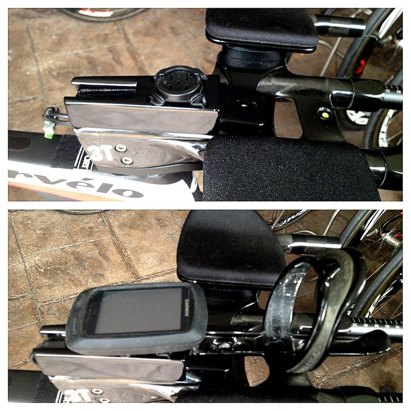

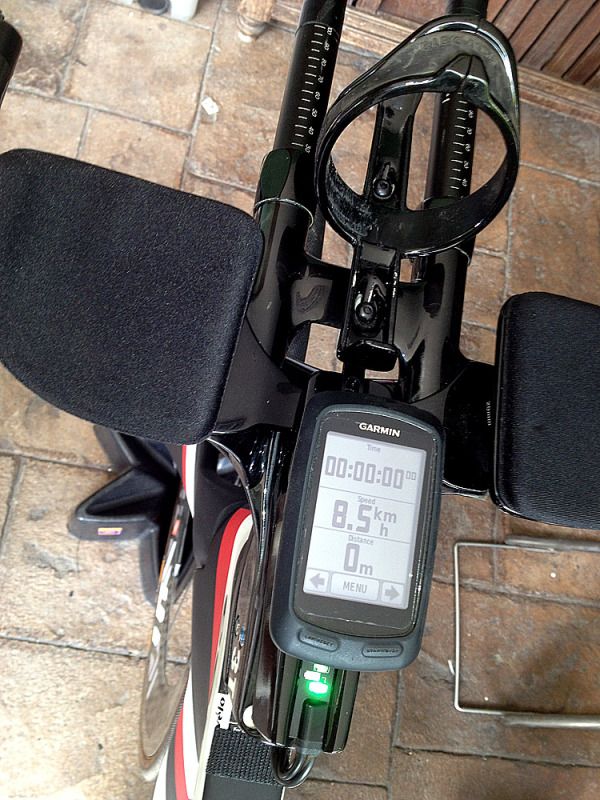

I fabricated a mount that sits just on top of the low stem.
Attached using one of the bottle mounts and double adhesive.
I put the Di2 indicator, Garmin mount & still have the bottle in front.
Haven’t finished the build but it all seems to be where I want it.
Working on the bento that will flow behind it.
http://img.photobucket.com/albums/v236/campled/Bike%20Projects/RCLP5Garminmount.jpghttp://img.photobucket.com/albums/v236/campled/Bike%20Projects/RCLP5Garminmount2.jpg
