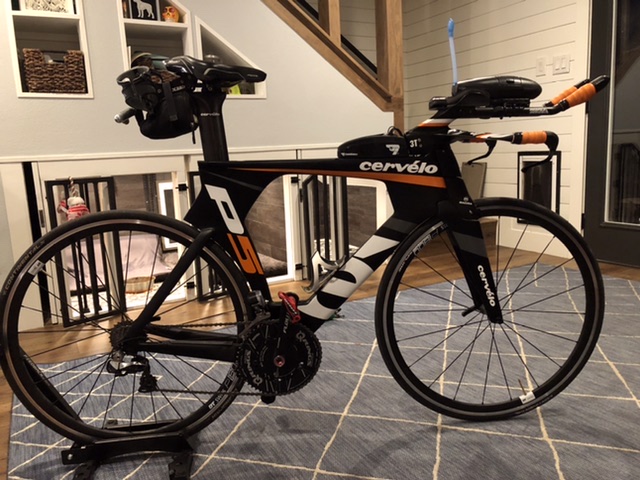

I bought a nos p5-6 a few years ago, and installed tririg brakes on it. Works great. You’ll need more spacers that normal on both ends to make this work. I also modified the brake covers to attach via magnets to the front. I glued both sides together with some plastic specific epoxy and used the sugru putty to install the magnets in. It was some work but ended up looking good.
I bought a lightly used P5/6 and planned on converting to mechanical brakes when they Magura levers failed. Similar to the OP, I went to ride one day and had barely any braking power and an oily lever. I went with a tri rig and Shimano Ultegra levers and could not be happier. Its not a matter if your Magura brakes will fail, but when. Do you want to travel to your big race and then be stuck trying to find a proprietary part that is no longer made? As a bonus, the tri rig brake pads match my color scheme. Austin Tricyclist in Austin did the swap to mechanical and fit the original cover over the tri rig. Looks stock, in my opinion. If anyone wants a set of maguras for parts, PM me.
Wow thats a great job!! Did you do the back also? You have convinced me to mine-can you confirm what else i need to buy besides the brake and levers (does the omega also fit on the rear?), cheers.
I’m getting the spec on the rear brake now. I just texted the shop to ask the mechanic. My opinion is that the hydraulic rim brake was “cutting edge” for 2012 but it’s just not a great option in 2021 when the parts are not supported by the manufacturer. UPDATE: It’s a TRP brake that they make for Cervelo. It’s pretty common for people to switch to mechanical at some point.
Awesome thanks! Just to be sure was it the TRP T925.1R?
@runboorun and anyone else who has done this-how do you fit the original front cover on to the new tri rig brake? Can’t see anyway to do this, do you glue it??
I put the magura covers on Omega X.
  1. Glued the two magura halves together
  2. Enlarge the cable slot because the magura hydraulic line enters the top further back
  3. Glue the omega x cover inside the magura by shoving it as deep as it will go.
I also covered it in black vinyl so there are no magura logos or holes, and trimmed the brake arms to get the tririg brake closer to the head tube. That area is non structural, so it’s not an issue. Skip this step of you want but then the cover might be a bit further forward than stock.
