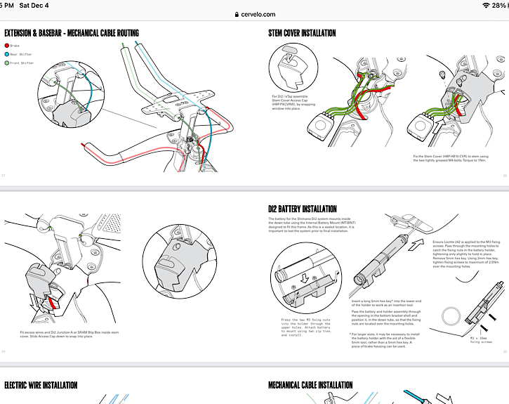

I am trying to get to the di2 box to charge the battery.
But how do I get the cover loose without breaking it? I am sure I do something wrong but I can’t get it loose.
Not ridden this bike myself, but perhaps the manual helps?
Especially pages 22/24/26 :slight_smile:
https://www.cervelo.com/media/gene-cms/p/3/p3x_manual_v5.9_web.pdf
turn bars in either direction. Pull tab at bottom of cover slightly out. Slide cover up
I have already looked at the manual, looks a simple slide in place thing when you place it.
