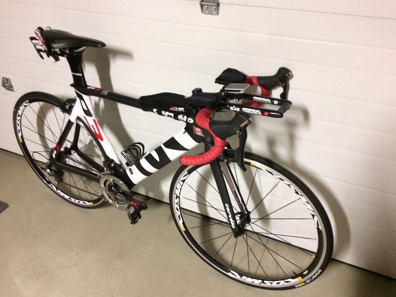

I converted a P2C into an aero road bike, I think the geometry is the same as the old P3C:
https://www.flickr.com/...933@N05/17470773863/
I use it for crits and for “road bike TTs”. It is definitely not comfortable but fast as hell! I do not use it for road races longer than 3 hours. I have no problems to go fast through tight turns in crits.
I have long legs and long arms but a short body, with the 140mm stem and the low stack long reach of the P2 I can come close to my position at my dedicated Ridley Dean TT bike.
Yes the geometry of size 51 was the same for P2C and P3C, but larger size were different (the P2C was taller)
