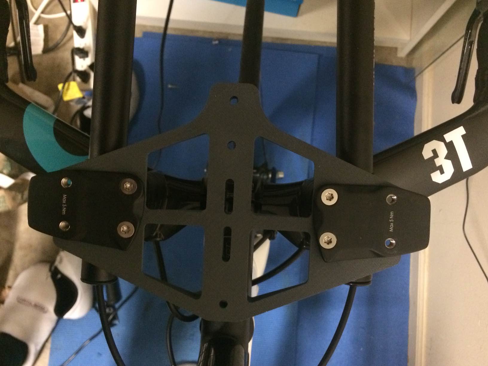

**1. **Design a bridge that would re-use existing provisions on the 3T VOLA aero-bar.
I came up with few different designs allowing to have the bottle cage installed on the bridge at few different locations (forward & aft).
The bridge holes are exactly at the same locations than the 3T bridge.
I have done few designs where the bottle z-location (height) could vary (see pictures) but for aerodynamic & cost purposes I will keep the bottle at the same height as the arm. (i.e. the final bridge most likely going to be a plate: V1 on the picture below).
**2. ****Prototyping check **
I have used a 3D printer to prototype the V2 model (see picture). The 3D printed part is a plastic part ( ABS plastic) which is not structural. Tensile strength is around 31MPa, structural Aluminum like 2024 T3 have tensile strength in the range of 400MPa and carbon UD in the range of 600MPa in the fiber direction.
I have then installed the prototype on the bike to verify fit and function. As you can see on the picture the fit is perfect.
I have had no time to model in 3D the rest of the bar and the bottle/bottle cage but I am going to do so in the coming weeks.

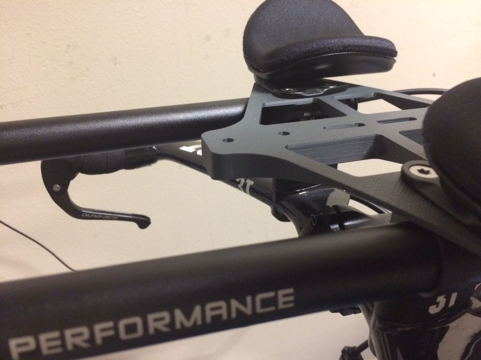

**3. **Short term solution
In the short term solution, I am going to use both the 3D printed bracket and the 3T bridge. I will installed the 3T bridge upside down. I just want to make sure the stock screws have enough thread engagement after stacking up the two bridge. If not I will get new screws. A good rule is to make sure you have at least 2D of thread engagement.

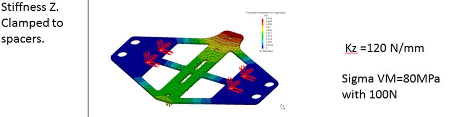

For the long term solution, I will be working to make the bridge structural, likely by using 2024 T3. The thickness of the plate will be chosen so that it can withstand pre-determined loads. I am currently in the process of defining the load cases. I will also most likely model the 3T bridge and do a side by side comparison of inertia/stiffness and strength (all that using finite element analysis). My bridge is inherently larger than the 3T bridge but at the moment I don’t think I want to have it with the raise portion (as the 3T one).

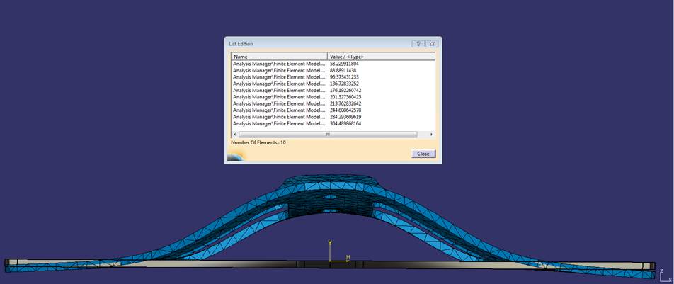

At the moment I am thinking the that the bridge is mainly taking load in its plane and that compression failure or buckling are to be checked.
To give you an order of magnitude using the design V4 a compression load of 100N in the direction of the bridge, it would take a load 58 times greater to get the first buckling mode. Meaning 100N x 58 =5800N = 591 Kg. I do not think anybody can put such load into the bridge. Stress in the bracket are not an issue with the 100N.
I am thinking that the shape of the 3T bridge is going to be more compliant than my bridge. I think the 3T bridge does have some built in in-plane springiness which probably enhance helps damping out some vibration.

Good job! You basically did what 3T should have done right from the start.
I hope they will include a bta solution like this when they’ll design new bars (I’m pretty sure I’m not the only one waiting for that).
I’d considered doing something like this for my customers (I did it for felt Bayonet 1 bar)
I would put in extra pad mounting holes too as the options on the bar are pretty limited - a well designed bridge could significantly improve the bar
NICE! When will you be marketing them? :smiley:

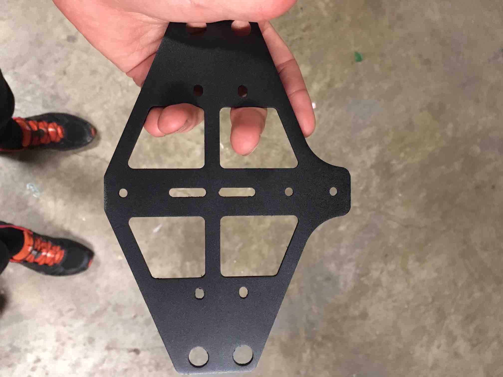

Small update on the project. I have got the final product laser cut from aerospace grade Aluminum 2024 T3, 3mm thickness.
The part looks great, I need to go ahead a weigh it. But before the next step is to finish up sanding and spray paint it black.

First off awesome design! What FEA software are you using? Also completely agree on the thread engagement 2x dia especially into aluminum. Probably the most frustrating thing on bikes these days is how joint design is overlooked.
Thanks !
For the FE models I used the solver built in CATIA V5, called ELFINI.
It is a linear solver and there is the possibility to compute the buckling modes for the structure. It is very easy to use when the part is design with CATIA, you can have the FE model in a matter of seconds…
The two front holes can be used to attached the bottle cage more forward but in my case I will use them for a computer mount (like garmin) that I will design and 3D print. I want to be able to have the computer visible when I am on the aero bars.
Minor update, the bracket is sanded, painted and ready to be installed !
