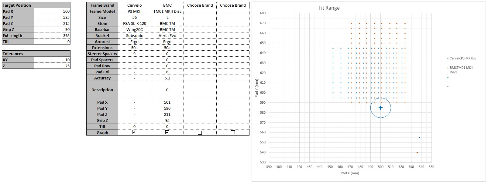

Longest Pad X (rear) for BMC is 482
Lowest Pad Y at 10deg is 595
So with standard parts you miss reach by 18mm, tilt by 5deg and stack by 10mm
Next generation BMC will work for you, but you can’t get one for a while and I don’t know what the price will be

Thanks for that! It’s interesting that when I plug in my fit coordinates on Cervelo it spits out that a 54 is what I will fit on. I’m assuming that running the subsonic bracket is how the fit works for a 56 since it lowers the stack? The fit on the new BMC is for the newest model and shows I can get into a ML with a reach range of 422-508 and stack range of 555-630 with the flat basebar. But, availibility…

I’ve made a better calculator for the current BMC, though I have to warn that their data is inconsistent so I can’t be sure of the stem dimensions
It now appears that the only miss for your coordinates is the tilt, which maxes at 10deg on the Aeria Evo bracket.

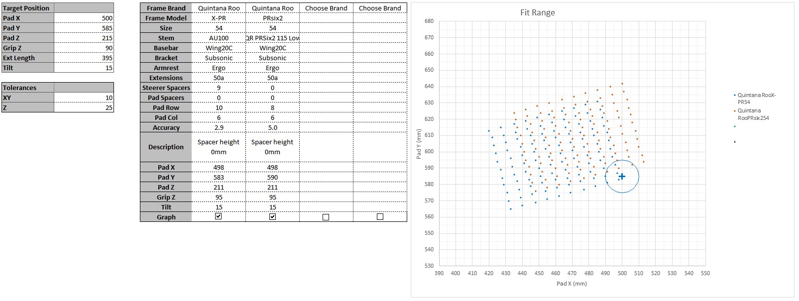

To illustrate the difference tilt makes - here are the bikes at zero
Now with 15deg (or limited to 10 on the BMC)
It may be worth talking to QR as you might be able to get the bike configured in the way you require from the outset.
I should probably sit down and see what I could get in the $6-7K range for QR. not sure I like the mechanical disc brakes in the X-PR and the V-PR is too much $. I’ll have to take a look at the PRSix2disc.

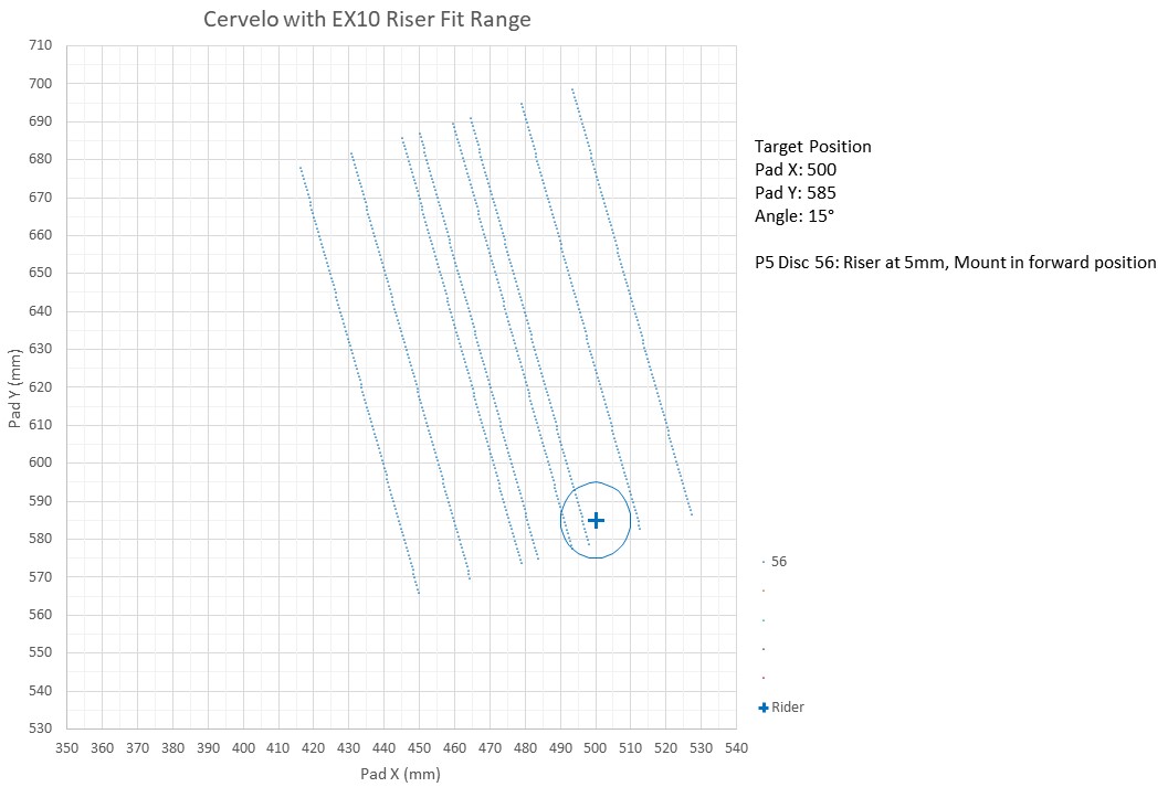

What’s the lowest pad Y that a P5 will get me in a 56? I assume that getting 500 for pad X isn’t a problem. I’m starting to think I can get two different aerobar extensions and pedastal the left like I am on my SC now and still have the same grip on the aerobars.
P5 Disc?
497, 584 is the closest solution
You haven’t mentioned your pad width - that is a constraint on the P5D, especially if you’re going to stack up the left side
290 outside-to-outside, 175 center-to-center of the mounting bolts for the older Tri Rig pads (I guess their the equivalent of the mini open back scoops now). I have been narrower before by about 30mm, but had to widen to fit a BTA bottle there.
You’re fine for width, make sure you get high grade bolts for the pad-riser setup.
Looking at my list of extension dimensions, USE appears to be the best chance - cut down a high rise on the left to get the correct stack increase over one of the standard ones on the right
