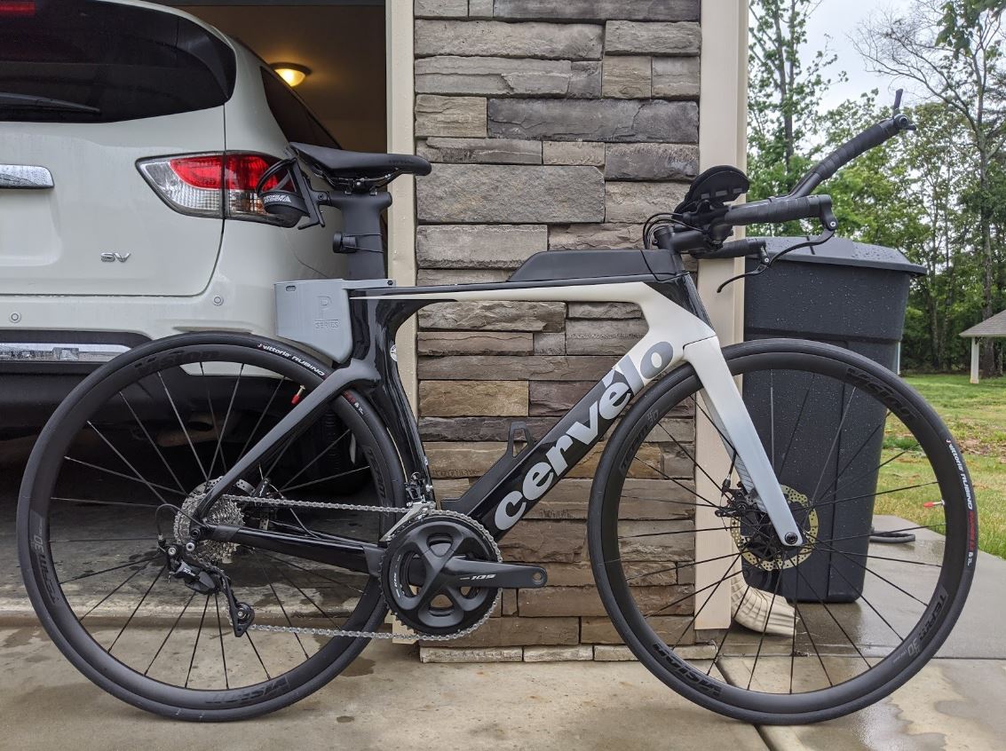

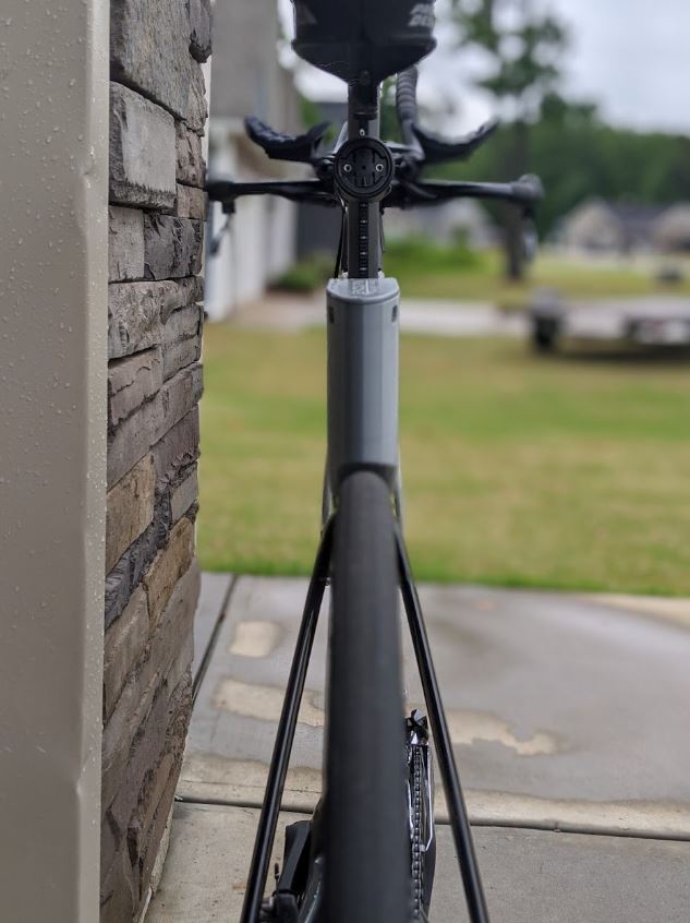

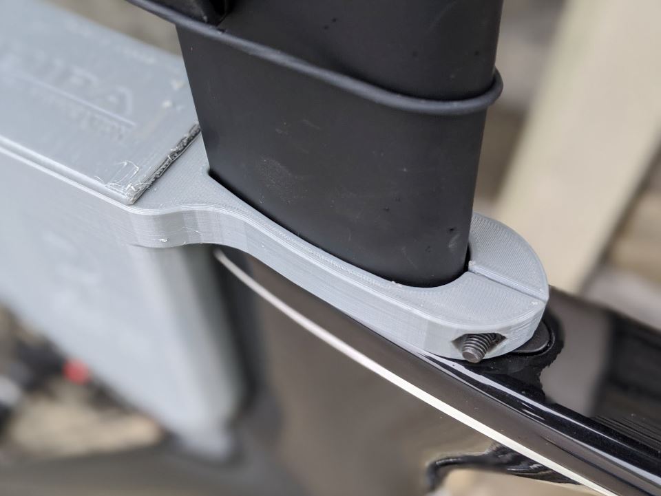

Finally result of my time, invested in my lovely P-Series Disc during quarantine. I was looking for DraftBox and Varia Radar mount for several month. But decided to spent some time and get it done by myself, since i’m Mechanical engineer and got right tools and connections to make it happen. Here is the prototype i’m pretty happy with i have received Yesterday (still planing to change a little bit release buttons and shave some weight from wall thickness).
This one was printed on Markforged FDM 3d Printer, just to check dimensions and design concept. Final DraftBox i will be also 3d Printing but on industrial grade HP MJF Printer with Nylon 12 Material. As for now, cheapest quote i’ve got is $145/box with order of 10 pcs. and $120/box with order of 50+pcs. (does not include Taxes and shipping). Varia mount need revision and I will post more details later.
If someone is interested in it - let me know in the comments. Also need advise and some measurements taken from non 54 Size bikes. Just to make sure fit with other frame sizes or model will be changed accordingly. After i will revise it i’ll post 2d drawing to print in 1:1 scale so you guys can cut it and use as template to check clearance. Do not hesitate if you have good ideas for improvement or connections to print them cheaper!

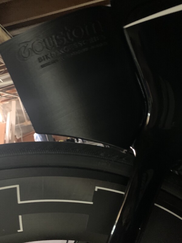

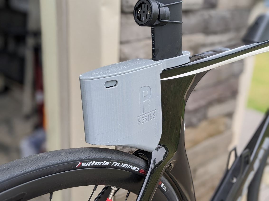

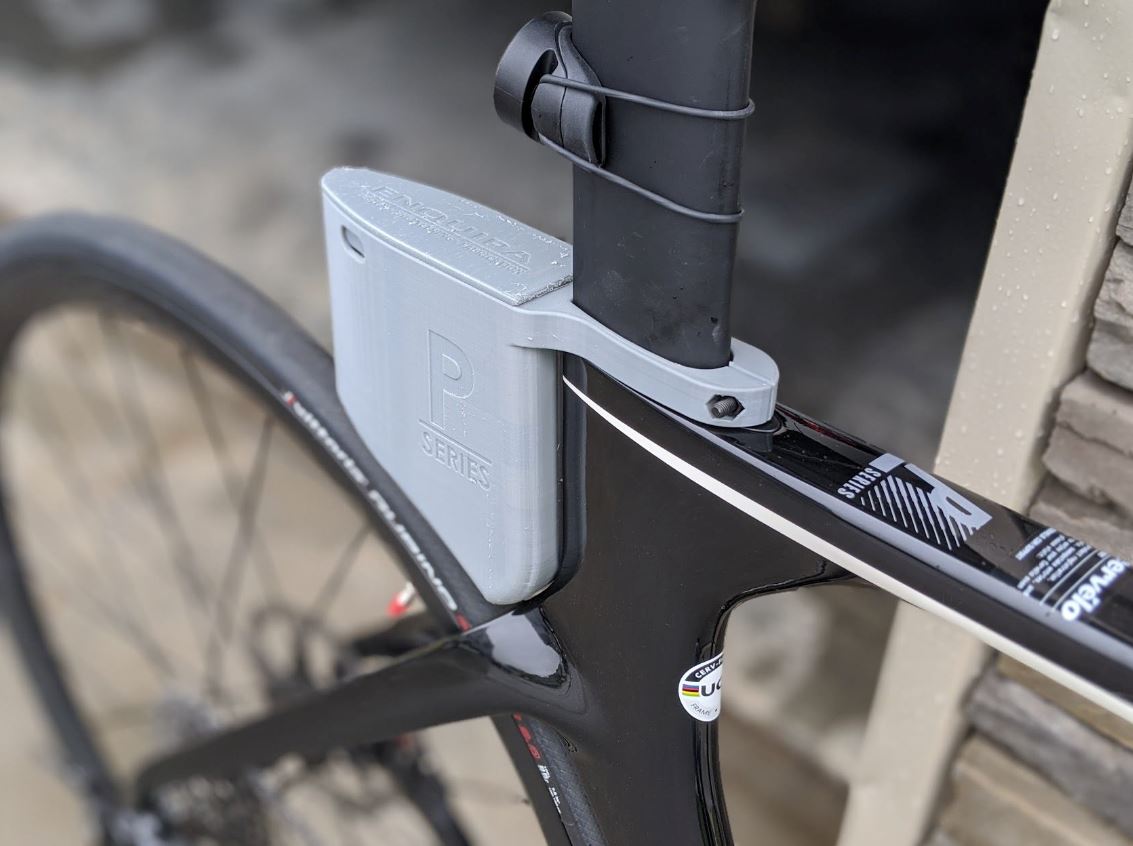

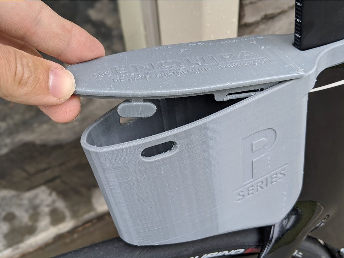

I’m currently working with a customer to design a box for the 56 cm P Series, I’ve sent him what I hope is the last prototype to test fit on his bike. I should know tomorrow if it fits fits against the frame properly.
Here’s a picture of the last prototype he got. It’s very close to fitting nicely against the back of the frame.
I’m starting work on a box for the 54, but need someone in the US with a 54 to test fit the prototype.

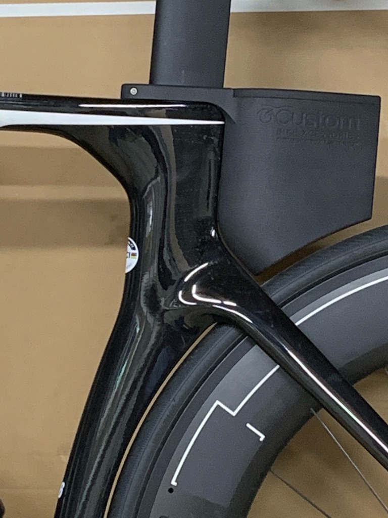

The size 56 box has been finalized, here’s the production box on a customer’s bike
you can order it here https://custombikexcessories.com/products/ols/products/cervelo-p-series-rear-box
I’m going to start work on the 51 and 54 boxes this week

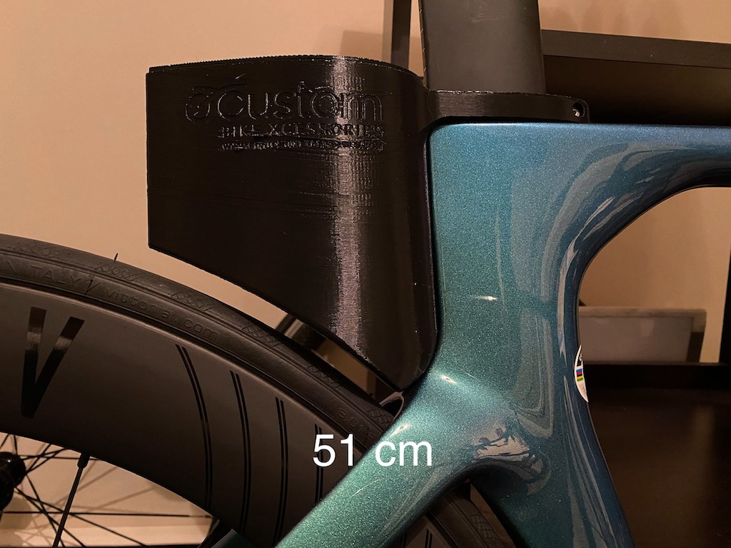

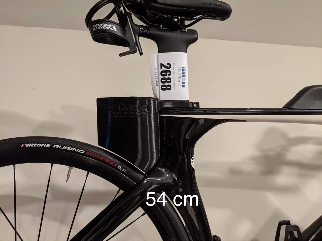

The box for both the 51 and 54 have been finalized.
Here’s the 54 finalized
