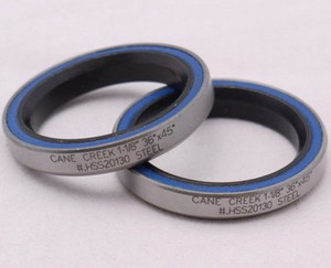

This has never happened to me in all the travel with bikes. It seems that on the new P3 the bottom bearing is not the sealed type. In putting thr front end back together post air shipping, I may have started to tighten the headset bolt while the bearing was at an angle, at least it was not properly seated. So then I retried again only to find that the race holding the bearings was bent and several ball bearings had popped out. I did manage to straighten it out by hand but now the race is missing several bearings. I was able to tighten the headset in place, but it is missing a bunch of those bearings. While it seems to work I would guess the thing will end upp being pitted in a few rides. I am going to search around the village in Whistler for a replacement, but any risk of a catastrophic failure? If anyone is handy mechanically, what size/type replacement should I get?

Jonnyo, thanks. I took it for a spin around the block and everything is secure. In theory there is some redundancy with the number of ball bearings, but still don’t want the headset freezing up on me when I have to turn at 70 kph. Do you know the steerer tube diameter (I think they are 1 1/4 inch)? Worst case maybe one of the loocal mountain bike stores can give me a race that mates into the Cervelo set up?

  1. Chances are excellent you’ll have no problem racing on your damaged bearing.
  2. As part of the “Simply” aspect of the P-series “Simply Faster” mantra, your headset’s bearings are the most common headset bearing in all of modern cycling, 1 1/8". Available from too many vendors in too many models to list. Cane Creek, FSA, etc. etc.
  3. Random photos from the web:
http://i.ebayimg.com/t/CANE-CREEK-HSS20130-STEEL-Cartridge-Bearings-SUIT-S2-S3-S6-S8-ZS2-IS2-HEADSET-/00/s/NDA2WDUwMA==/$T2eC16hHJHgE9n0yHGLBBQ3Rg-!NnQ~~60_35.JPG http://www.sjscycles.co.uk/images/products/medium/Cane-Creek-cane-creek-headset-bearing-sealed-for-s-2-s-3-zs-2-is-2-1-1-8-inch-IMG20756.jpg
  1. Only danger is you might find a Campy standard bearing (45 x 45 degrees), but that’s not likely; they’re not too common.
  2. Good luck, relax and “have a great time” in Whistler!

So just to correct my previous statement, the actual bearings are sealed? But what I say was the bearing race and inside prt coming apart while the metal outer part was up inside the frame. Now everything is seated and mated back together with the compression of the middle headset bolt applying the force to pull the entire complex back together. But what I should normally see is the entire sealed bearing complex popping out, not just the race and inside part. Correct? Is there an easy way of popping out the metal part (outer part) if I find a replacement sealed bearing system?

Many (not all) MTBs also use this size. Tapered MTB headsets often will use this size for the top bearing, with a bigger bottom bearing (which has no effect on your choice). This upper size fits your P3 top or bottom, they’re the same and interchangeable.

The bearings are “sealed” in the sense that you’re not supposed to take the inner and outer races apart. The mis-aligned fork assembly after travel obviously damaged something, such that the inner race did separate from the outer, not as intended of course.
The outer race will slide out of the frame (there’s normally about 0.5 mm clearance so it should just fall out). Unless it’s jammed or bent badly. Then I’d suggest pulling it out with whatever you can find - small screwdriver? Spoke? needle nose pliers? The outer race isn’t that rigid, so one way or another it should come out.

Thanks for posting the pictures. I showed the picture at one of the stores at the expo and he saw it was a 36x45. Got the bearing, came back to the hotel and it was a 5 min “surgery” to get the old outer out (used a fork froom the hotel to push it from the top of the frame hole, then place the new one on the steerer tube, PROPERLY SEAT EVERYTHING and tighten. Will post pictures later.
