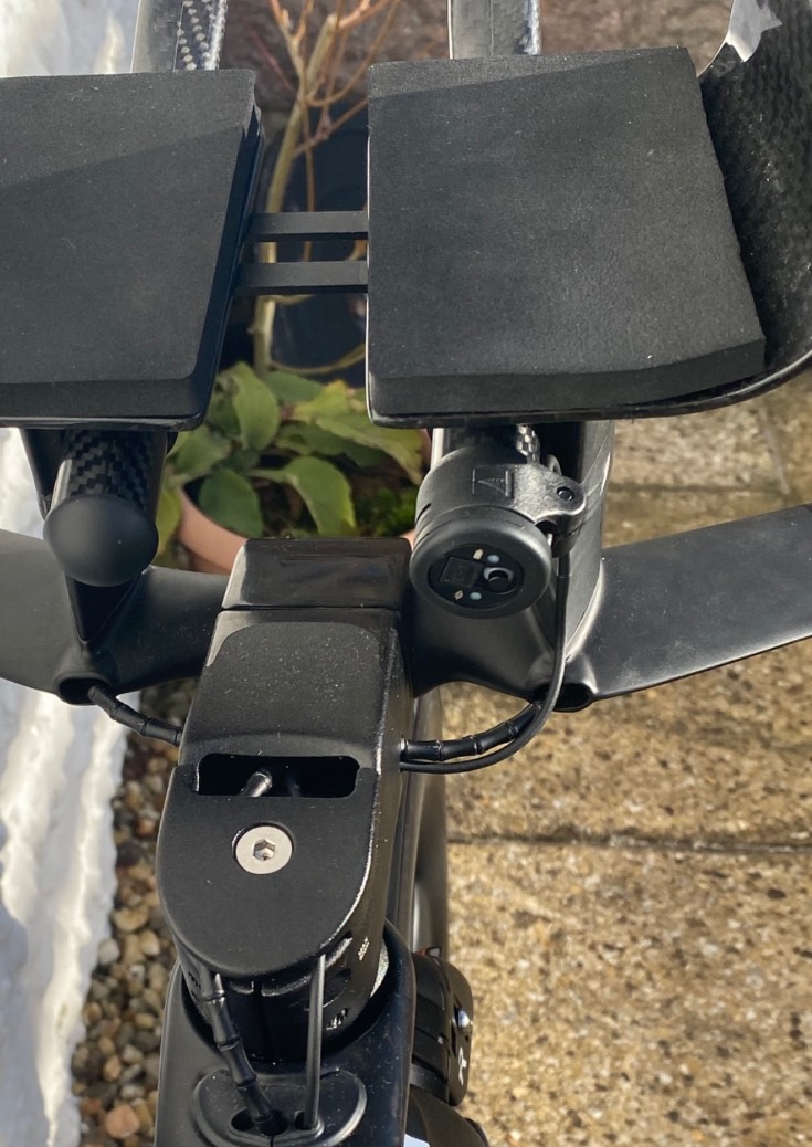

https://profile-design.com/products/aeroport-di2-rs910-adapter
Set the aeroport on its side to line the cable up nicely with the port at the top of the riser

With this you would still need to cut a slot or drill a hole in the extension to get a wire out, or am I missing something?
I put a 5 port junction box in the small bento.
I have used this solution although not on a Cervelo.
The bracket holds the RS910 slightly off the back of the extension so the cable can exit
have a look at page 6 of the manual if you’re interested

Did you check that your extensions meet the 19mm ID requirement for the RS910?
All Ally is fine, carbon can be a problem.
They are yours! 4525 carbon. Love the bend on these.
Will it work??
If they’re SLC, yes
If they’re pre-SLC, no
The inner diameter opened up on the SLC so the RS910 could fit inside. That was the point of the update, lighter was just a consequence of thinner walls.
How do I determine?
Mine have a provision for cable entry. Appears the SLC do not???
Only way I can think of is to take the tape off and check for the SL badge up on the grip
https://profile-design.com/cdn/shop/products/4525-SLC-Extensions-02.jpg?v=1648507486
Old style. Ugh.
That a PD Aeria Ultimate stem? I’ve been looking for some ways to help a friend clean up their Felt IAFRD RB front end and your picture looks tight. Good Job.
It is.
