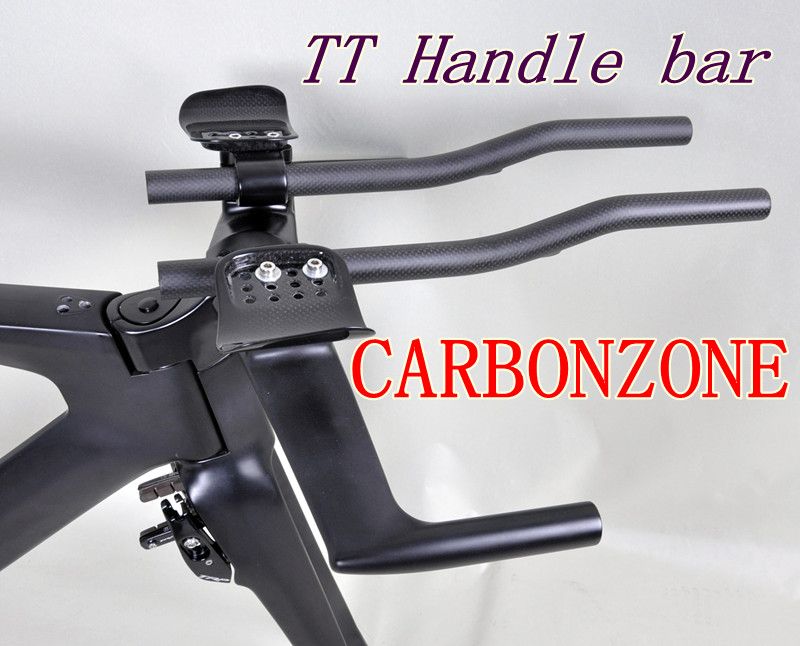

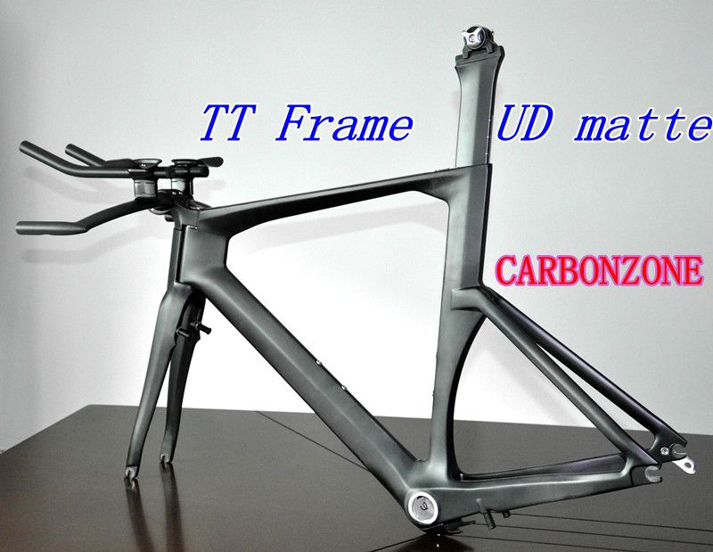

I am assembling the new frame from Carbonzone and wanted to know if anyone is up on the new UCI rules and if it is compliant? What concerns me is the front fork that connects to the handlebar neck forming what could be a fairing?

Not sure if the fork/frame combo meets the 3:1 regulation, but the basebar certainly looks >3:1 and would be rejected. The seatpost may also have that issue.
http://i998.photobucket.com/albums/af110/carbonzone/TT%20Frames/Fm069UDmatt4_526F672C_zps424b7be2.jpg
http://i998.photobucket.com/albums/af110/carbonzone/TT%20Frames/Fm069UDmatt6_526F672C_zps9593041e.jpg
