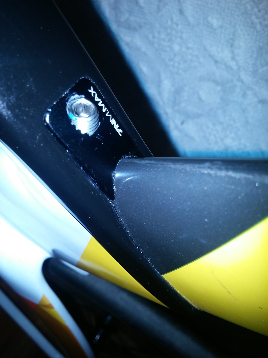

So this morning after lowering my seat post, the whole seatpost got stuck. I immediately took it to the bike shop and they removed the seatpost after a couple of minutes. They applied some fibergrip and put it back without tightening the binder.
After I come home, I apply about a quarter tube of fibergrip on the seat post, around the seatpost area, inside the frame etc. to be 100% sure that it will never get stuck again.
Thereafter, I adjust my seatpost and just barely tighten the binder. I sit on the saddle for 2 seconds to confirm the height and boom, the seatpost slips down and is stuck again.
What the hell is going on?
See the attached photo.

You might be right. It also seems that the design of the clamp/seatpost binder is gripping the saddle too tight (see the photo).
