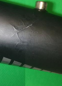

New Triathlete here, who after doing his first OD Triathlon on a bad fitting, too big old bike decided to get a budget chinese frame and it arrived but it has one scratch on it and I can’t tell if it’s the paint or if the carbon is actually damaged.

The depth is quite shallow which gives me hope.
I also did the “coin test” and uploaded it here, so if that helps heres a link: https://youtu.be/ERKB6e25v4g

Damaged, and structurally compromised.
Thank you, could you please elaborate what makes you sure of that? Just so I know what to tell the seller.
When your coin ‘plink plink plink’ goes ‘thunk’. Soft spot in carbon. Send it back, get your money back.
Agreed with that being a soft spot in the carbon based on the sound.
Sure: your photos. The relatively straight cracks at angles symmetric about the tube’s long axis, likely following the orientation of the fibers, are very typical of local impact. (Might be shipping damage?)
I assume shipping damage as well, the bike was packed really well and the shipping box didn’t seem to be handled well and had even had a dent which may fit exactly.
I looked inside with a flashlight and can’t see any issues from the inside but I’m not risking it.

So this is probably the biggest bump slowtwitch has seen a while but here we go.
The end result was that the seller insisted it was a paint damage, aliexpress sided with them so I was stuck with the frame.
On another note, because my other carbon frame got into a tiny accident with a car, I was worried about my new bike and checked on this POS again (doubt other than the fork anything had an issue, only had to tighten the screws in the head-unit again. My wheel is even still true.
So here I was, thinking about that pos frame still sitting in the package it came in and sanded down the part which was a bit nackered and these pictures are the result.
https://photos.app.goo.gl/Ws2vZhJ9YQx3yaod7
Here are my thoughts. I see some very, very tiny flaking in the carbon where the scratch was, but thats it. When I take out the bottle holder screws I get a better look as well and that part looks fine (no scratch, crack or whatever).
My next idea would have been to get an endoscope camera and try and look directly at it and try if I see more.
So…what do you carbon professionals say? waste of time ?
Still cracked, still structurally compromised…
IMO, if you still want to use the frame, send it to a carbon repair place and they should be able to repair that spot and it will be at strong as before the damage. Shouldn’t cost much. You’ve already sanded the relevant spot for them. :wink:
