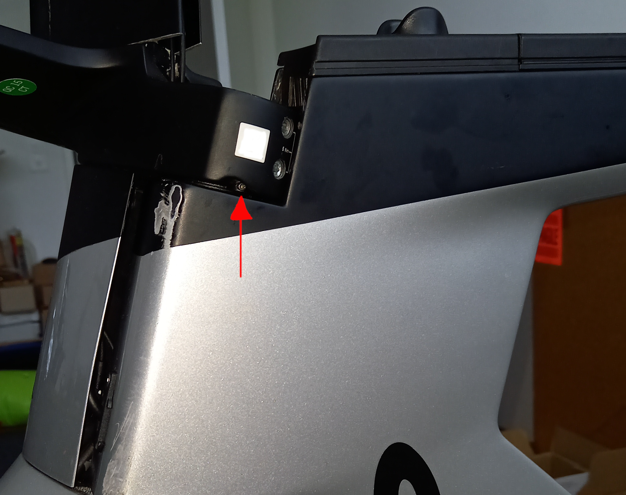

I just went through this on a test bike… before adjusting the preload on the headset (with the 2Nm adjustment screw) did you also loosen the clamping ring bolt? Otherwise you are simply increasing the preload between stem cap and clamping ring but not of the headset bearings. See the last picture of page 38. As described, you need to steer the bike fully to the left or to the right and then you will see the small bolt located on a ring below the stem. On the bike I had it was actually a very small hex bolt (not torx as per manual).
If you would like a picture of where the small bolt is located let me know.

Can you send a pic where the third bolt is?
Can you show me where the third bolt is? I don’t see it when I turn the bars left or right.
Here you go, see the attached picture. Handlebars are turned to the right.
