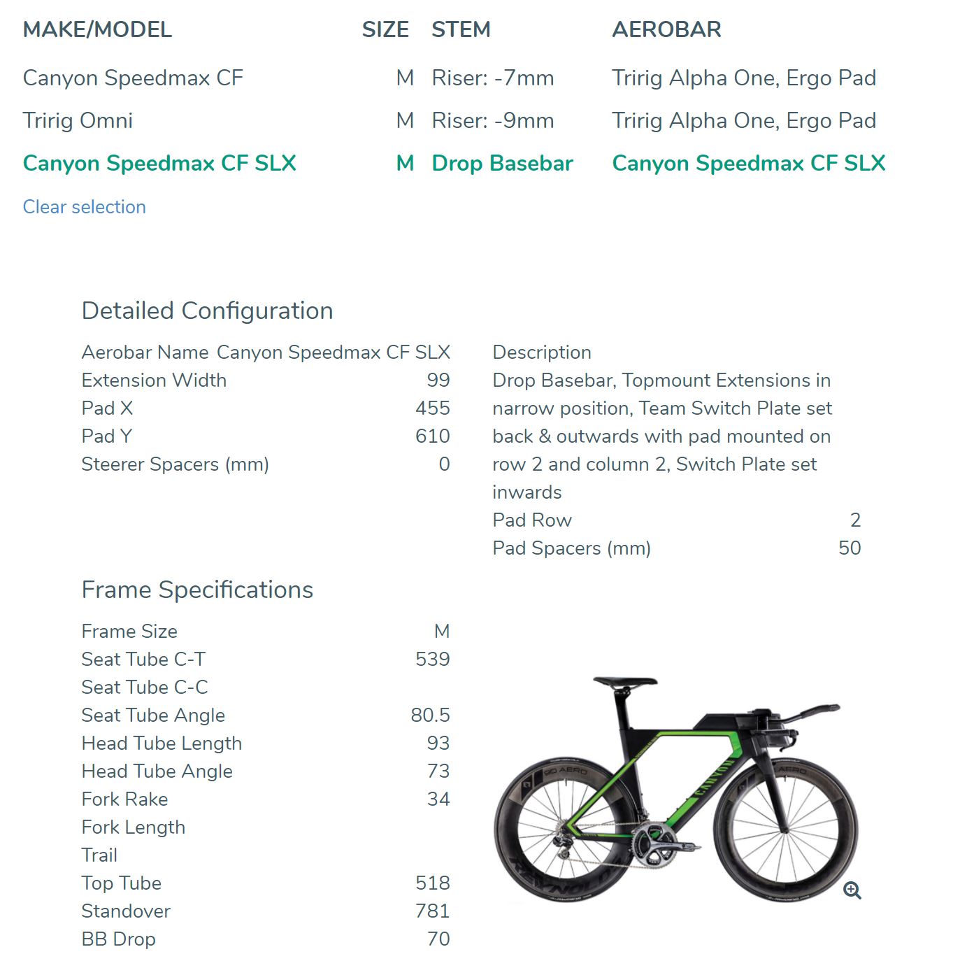

Looks like I need to tune the Alpha One calculation to not use steerer spacers on the Omni, so the rise would be a little higher than that.
Note that I assumed your stated pad X was to centre, so took off 40mm for the search.
Before you base any decisions on the above, we’d need to know if your friends Pad XY is based on the bars being tilted or not. The level of tilt in the Dimond pics you’ve shown would change the numbers above quite a bit and may invalidate the Canyon
