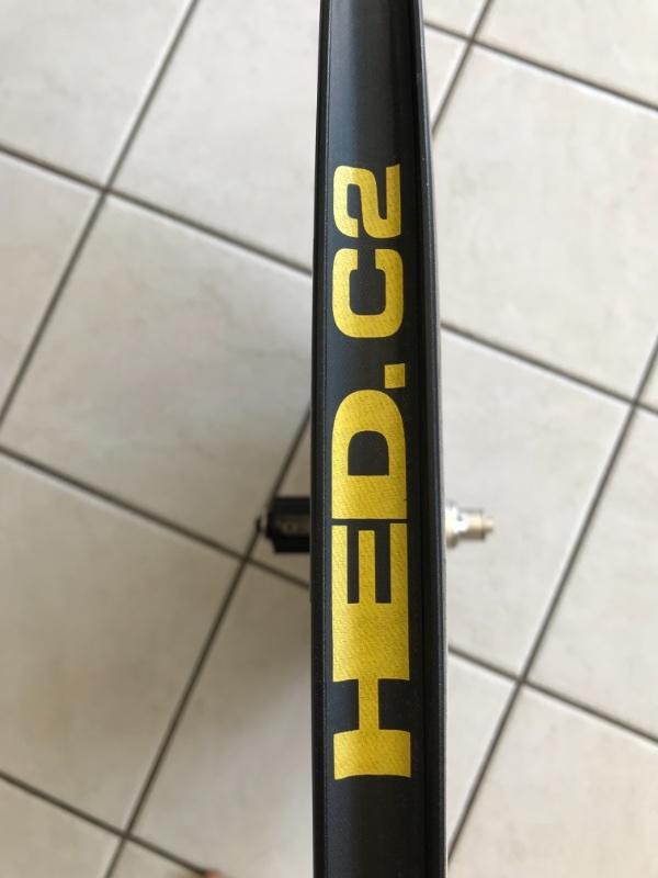

Apologies for butting in. What about the reverse? I have the option on a HED Jet C.2 disc, but it is Campy. Need it to be Shimano. Possible?
If it is campy then it can go to shimano.
