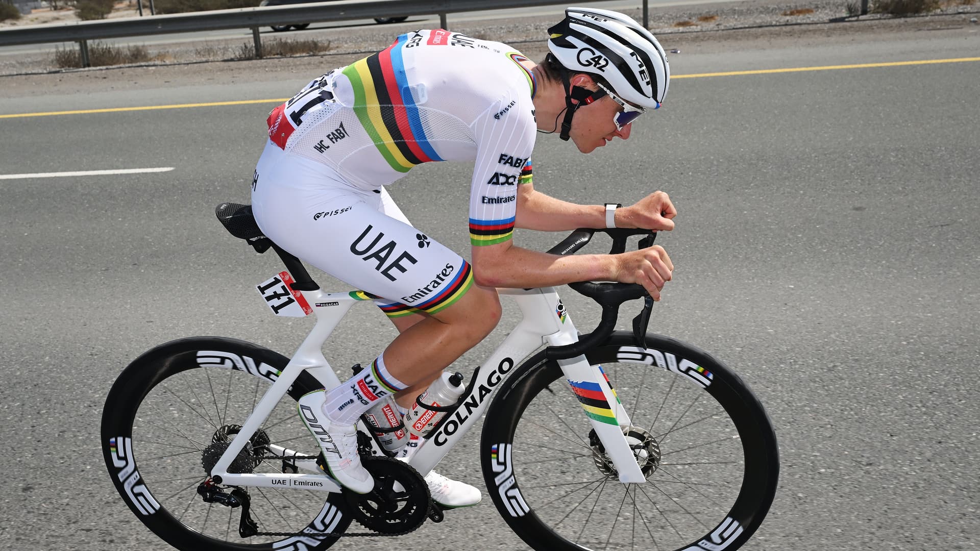

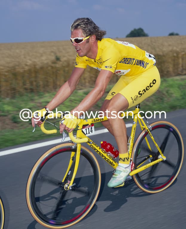

Fit and positions have changed over the years…
Past and present look very different
It appears that Pogi rides one size smaller than he has in the past and what he would traditionally measure up to. Apparently he rides 165 cranks. He’s seated well forward on the bike - but I assume it still meets the UCI saddle set-back from BB measurement. His hip angle is really open. He rides with VERY high RPM - all the time. Particularly when climbing!
Both of those pros have had success on their fits.
I see the same kind of change on my group rides. Guys with the newest/latest bikes almost seem like they’re riding one size down. Buddy of mine still rides his old steel Mercx frame. He’s stretched out over the top tube like Cippo (but can’t sprint like him :rofl: )
