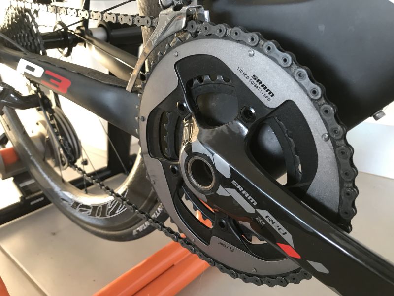

I would have expected that crank to work. I run a Sram Red 22 GPX integrated crank in BBright with no probs.
https://forum.slowtwitch.com/forum/?do=post_attachment;postatt_id=13744
