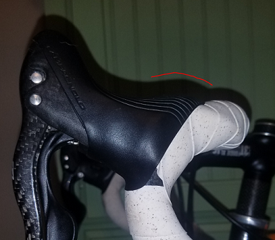

The second pic shows the plastic part of the shifter that is causing the trouble. Note red circle.

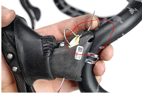

The third pic is my bike. Note the red line on the shifter’s shadow.
A lot of it is in how you do the tape. If you wrap a thick part of the tape over your highlighted area it exacerbates the bump. If you line it up right the tape smoothes the transition.
Often for shimano I’ll put an extra bit of tape in behind the hood body to fill in the gap. Paying attention to this area is important for every brand of shifter.
I hear you, but I’ve tried that. The lump is plastic. Putting an extra layer of wrap before it is easy, after it not so easy, and it looks terrible. I can’t get past the idea that Campy has this figured out and I’m just missing what they intended.

Luckily for me mine don’t seem to bother me. Those bars are off the bike now and there is no tape on them but I don’t remember it being an issue when they were on. I can’t say it was a great tape job that filled the gap so I guess I was just lucky. However, if it was bothering me enough, I’d take my Dremel tool, or even a file to them to smooth the bumps out myself. It looks like removing some of the material won’t leave it unnecessarily weak.
Hmm. That dremel idea is interesting. But I’m still thinking that I’m missing something. Is it possible that Campy users don’t grab the flat part at all? Like maybe they actually grab the very end of the brake housings that stick up? Riding with my hands, bearing a fair amount of weight, on a horiz surface just makes no sense to me. How do people do that without cocking their wrist at a weird angle?

I just pulled my controls off because I will be buying a new bar soon, but when I take a closer look at the plastic underneath the rubber it seems plenty beefy enough to grind the bump off into a smoother transition.
