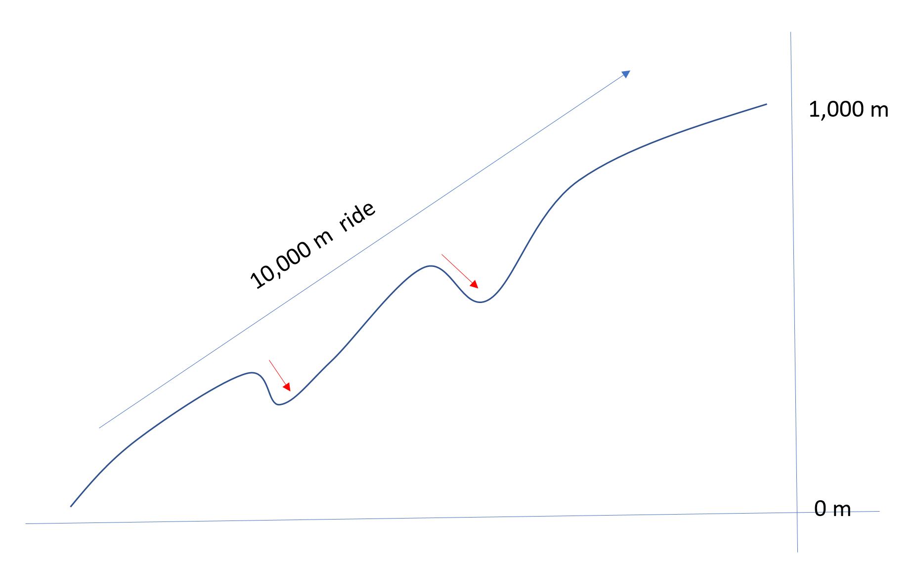

Calculating Average Gradient of an uphill route that includes negative-slope parts on the way up
Hello All :slight_smile:
What’s the right way to calculate the average gradient of an uphill route that includes parts with negative slope on the way up ?
Thanks!!

Ya I am not a math guy - I literately walked over to my friend who programs the models and does absurdly crazy math wizardry that I could only dream of - and not dream of because I am not even at his level to dream that stuff up - and he said it really depends on how you look at it and what exactly you are trying to do but since you don’t have super specific instruments to measure it then you are kinda back of enveloping it anyway so just do it in a linear fashion.
I mean like in the below example, 10 km ride generally uphill, from sea level to 1000m height - - - but with declines on the way up
That is the EXACT picture I drew for him. He said calculate it is basically using that straight line. y = a+bx. Linear.
Unless you want to break apart those segments but since it is an average it will pretty much equal that straight line
Yeah…it depends on how close you want to look. Assuming all I wanted to know was roughly how steep was the uphill portion of a ride I would do something like:
ascent + descent
total_distance * (ascent / ascent + descent)
The above assumes that the ascent grade is approximately the same as the descent grade…something which I found pretty reasonable when I lived in Colorado. Sometimes the backside might be considerable steeper (or less steep) than the front side…but, usually they are similar. it also assumes that the end point is the highest point (in other words all descents are followed by an ascent to a higher altitude). So, it won’t work for a round trip.
It also assumes that everything uses the same units (feet, meters, etc). So, convert miles to feet, etc. The above can be done using the data available from a typical GPS watch.
I think that 1,000m / (total ride run, including declines) is both right and simple.
it takes into account the fact that in the declines one ‘runs’ but not contributing to gaining of height (the opposite)

Yes, it is simple. And if the question you are asking is what is the average slope of the entire ride, then it is “right”.
If the question is how steep is the road while I’m climbing, then your approach will UNDER-estimate the uphill slope. The degree of error will depend on how much descending actually occurs. In your example:
1000 / 10000 = 10% average grade
What if those two descents are 100 m each? In that case, you climb 1000m, descent 200m, then climb 200m. So, you’ve climbed 1200m in that 10km. That’s a 12% average grade. But, you also were only climbing for 80% of the total distance, or 8km. So, 1200 / 8000 = 15% grade for the uphill segments. So, when you are actually on your bike and going uphill the difficulty level you feel will be the result of a 15% grade—that’s considerably different from 10%.

So, what you’re saying is you want to know what the average is of ONLY the uphill portions…
I beg to differ; it won’t be 12% because if you add the incline you should add the decline too to the calculation and that will even them. Perhaps in such a case, road segments should be calculated separately
Its not clear what the OP desire is. That was the point of my original question back to him.
When I personally evaluate a ride for “difficulty”, I usually just figure the ballpark grade based on combined ascent+descent over ride length. 4000up+4000down over 100 miles isn’t quite the same as 8000up over the same distance. But, its a damn bit better than ignoring the descents all together. As my legs get older, I sometimes think I’d rather have a steady climb up versus 100 miles of rollers.

NNAG: Non-negative average gradient.
WAG: Weighted average gradient, where weighting could be based on time, TWAG if like.
NNWAG: Non-negative weighted average gradient.
The possibilities are endless :smiley:
As for plain old average gradient…
Average Gradient = Rise / Run
Rise = (Altitude end - Altitude start)
Run = ^0.5
e.g.
Altitude start = 150 m
Altitude end = 483 m
Distance travelled along road = 3680 m
Gradient = (483-150) / (^0.5) = 0.09086 or 9.09%
It’s a reasonable approximation for most angles of inclination encountered on roads to simply use the distance travelled along the road as the Run value (since there’s not much difference between the values of the sine and the tangent at small angles of incline). It’ll very slightly underestimate gradient. For very steep inclines you really need to calculate the horizontal run though.
e.g. (483-150)/3680 = 0.09048 or 9.05%

Can you elaborate on what the “run” calculation is taking into account and why it is needed??? I’m not following at all why the second, simpler calc of 9.05% is not factually correct if we are calc-ing “average grade”.

Because gradient is defined as rise/run. The distance travelled along the road is longer than the run.
Distance travelled is the same as the hypotenuse of a right angled triangle, while rise and run are the vertical and horizontal distances respectively.
As long as there is a non-zero angle of inclination, then Run < Distance travelled.

Ah, now that you’ve drawn the picture of the right triangle, i see what you’re saying. The picture is, as always,“worth a 1000 words”. Thanks!!!
