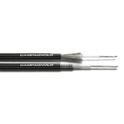

cables came in, looks like there is enough housing but it is too big. It came with 5mm housing and I guess I need 4mm. I cant get it to pass through the holes in the top tube. I was only able to get 1/3 through. I’m going to order up some 4mm cable and try that.
Just double check that you haven’t mixed up the gear casing and brake casing. I just checked my road bike and the gear casing is 4mm and brake casing 5mm. Brake casing is made up of a coiled metal liner, the gear casing has wires running lengthways along the cable, brake casing is much stiffer than gear casing.
Here’s a pic, casing on top is gear casing, bottom is brake casing
http://i1285.photobucket.com/albums/a597/nickag1/20e1289bd1770bdc38662455121cc0a3_zpsf46e0d7a.jpg
Wow, thanks, so yea that was the issue…
All better now
