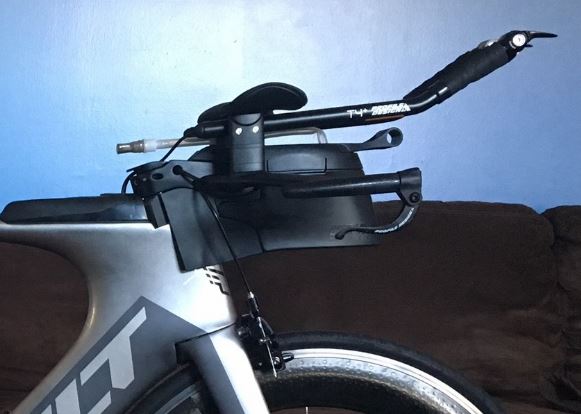

I ride an IA10 with the Aeria stem and hydration system. I use the Enve SES TT cockpit however I swapped the aero bars for T4’s. I’ve ridden without the hydration system and a bottle between the bars instead, just to try it out, felt faster and more efficient with the aeria. Depending your drop in the front and the front brake you use, you may want to take some measurements to make sure the aeria will fit.

I preferred the aeria over a regular bottle zip tied in and over the xlab torpedo on my current setup. No data to back that up, just opinion, tried 3, liked the 1 more than the other 2. I fumble more with a regular bottle and the xlab didn’t sit well between my arms because they are so close together. The aeria sits just under my aerobars so it doesn’t alter my position or touch my forearms, and for a drink I just pop the straw up. 9 of 10 times I release and it falls down and magnet snaps itself right back in place.

I’m using Felt’s stock IA brake so my cable runs up the right side of the front end and doesn’t tuck behind. The TriRig should run smoothly up and through. The 2 things I would check, to get the aeria off the bike you have to be able to get a finger in behind the rubber side panels to push a little plastic clip upwards, it’s centered on the rig as the hydration piece bolts and clips on directly to the bottom of the stem. Reaching that with a brake cable in there as well might be tough, though doable I’m sure. The other thing is depending how far down the hydration system drops towards your brake and front tire, you may have clearance issues with the top of the brake and the bottom of the bottle.
Though not an IA, Potts first bike with Ceepo used the Aeria with a TriRig front brake successfully. There are some great pictures at the following link, and the cover demonstrates the clearance issue I’m flagging:
https://www.tririg.com/galleries.php?id=2018_05_Andy_Potts_Ceepo_Viper_R
Cleaning is pretty easy. On the nose of the bottle is a single screw, it’s what holds on whatever attachment you prefer for your computer if that’s how you choose to mount it. With that screw in, the top won’t come off. Take that screw out, the top pops right off, the splash guards come out and you have a 2 inch hole to get in there with a brush and scrub.

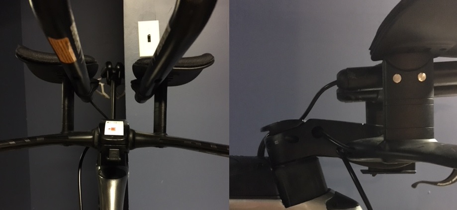

  1. I needed the reach. Here’s the front end without the hydration vessel attached. The black piece below the stem on the steer tube is a 3d printed part (I get a lot of questions on it when it’s actually visible). We needed the tube length for me to be where I’m at on this particular frame with this cockpit, my mechanic had the part printed so it would flush the exposed tube to the frame. Goal is to continue working downwards by dropping the pads and once I can make up for the stem drop via the risers of the cockpit, we’ll cut it and drop it.
