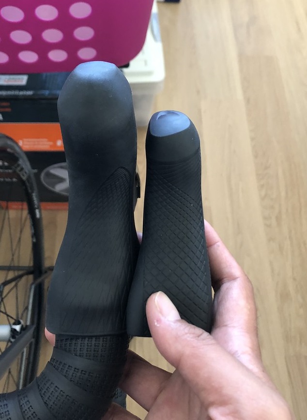

Any pictures you could post showing the hood size difference would be appreciated. I will build a gravel bike early next year and am interested in your take on the sizing especially for small hands which is my use case.
This was taken from another forum, it’s not my picture.
https://weightweenies.starbike.com/forum/viewtopic.php?f=3&t=162707&p=1591242#p1591214
