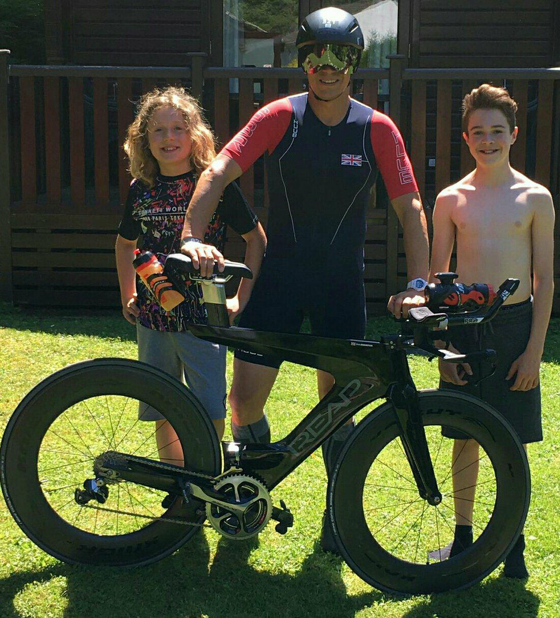

Hi guys. I use a BTA bottle for my fluids during a race but also a BTS bottle for all my gels (l slightly water down a GU 15 portion pouch) but find during the heat of battle l often waste time fumbling the get the bottle in and out and always have to come off the aero bars, so l am looking for something easier, but still BTS. Any suggestions?
Cheers AndyA
This is my current set up…

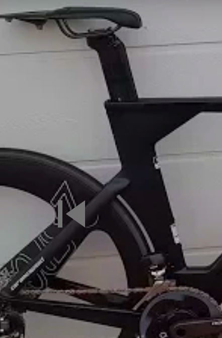

And one that caught my eye; an old Dash prototype l think?

I have that saddle. Besides doing a stellar job at ejecting bottles, it’s also impossible to reach.

Thanks for the advice l will stop looking for that one then! Maybe back to back BTA’s is the way to go…

Sorry to derail, but that’s the first REAP I’ve seen out in the “wild”…nice ride!
Yes it’s too good for me really; an incredible machine that carried me to a 7th place IM last year and onto the World’s this year. Happy days :slight_smile:

No bosses on the frame for that, as the maufacturer belueves it destroys the aerodynamics and l tend to agree.
Destroys the aerodynamics but you loose them each time you sit up and fumble with your bottle? Makes sense… I have the dash you have pictured but it is no different sometime you fumble getting your bottle in and sometimes it slides in easy. I would have thought the setup you have would be easier to get your bottle in.

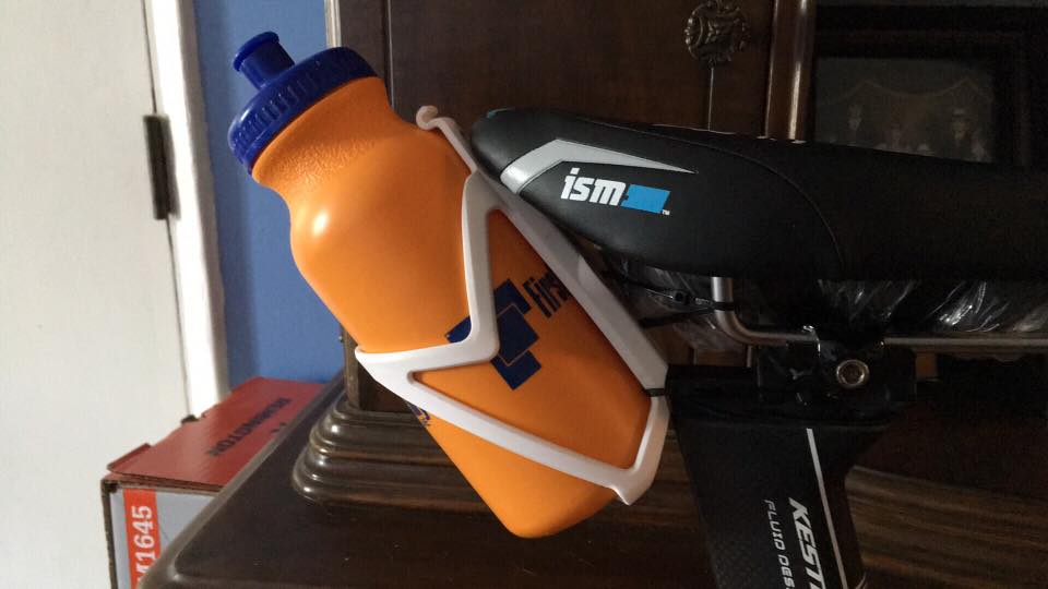

On my old bike, I would zip tie the cage to my seat and run a smaller zip tie around the front of the cage to “snug” it. With the bottle in the picture, it fit like a glove, in fact you could almost feel the bottle snap into place once you dropped it back in the cage. The angle was perfect, never launched a bottle. I just bought an IA10 and I’m planning to do something similar, though I want to try to DIY my way to 2 bottles instead of 1.
I got the idea based on Rinny’s setup, she ties a cage to her seat as well.
Maybe grab some zip ties and see what you can come up with? Especially since it sounds like you run a single bottle BTS, should be easy. I used a 7 dollar cage from my LBS and drilled out small holes in the cage where needed to run the ties.
