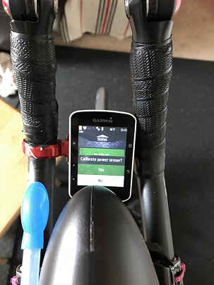

So I put the regular garmin mount on the back of the 520 (the one that will attach to round tube with rubber bands). This gives the back of the 520 some teeth that dug into the bar tape on the extentions. Then i just used electrical tape to make sure it didn’t pop out going over a bump or something. Worked great for a race.

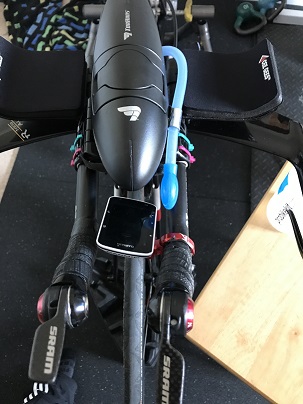

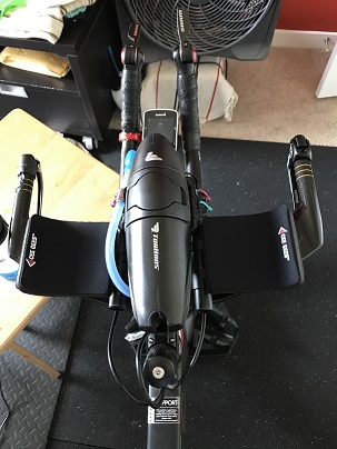

After a little tinkering and adjusting and twisting and turning, i got this setup
