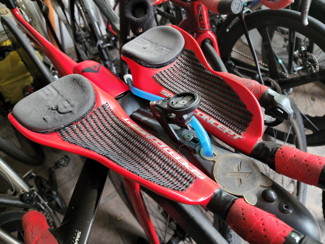

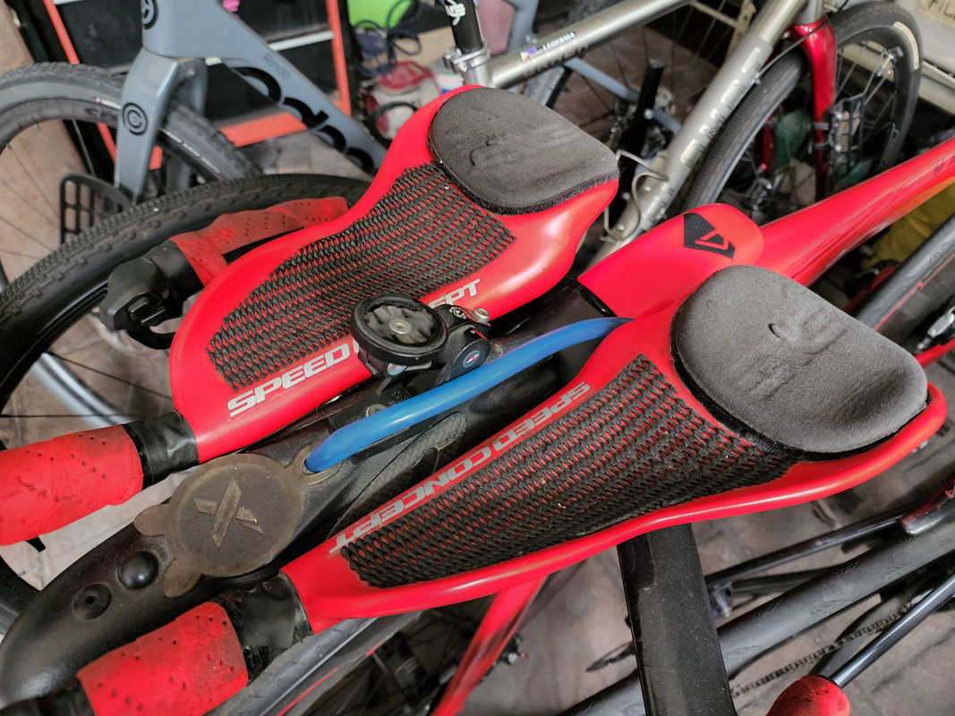

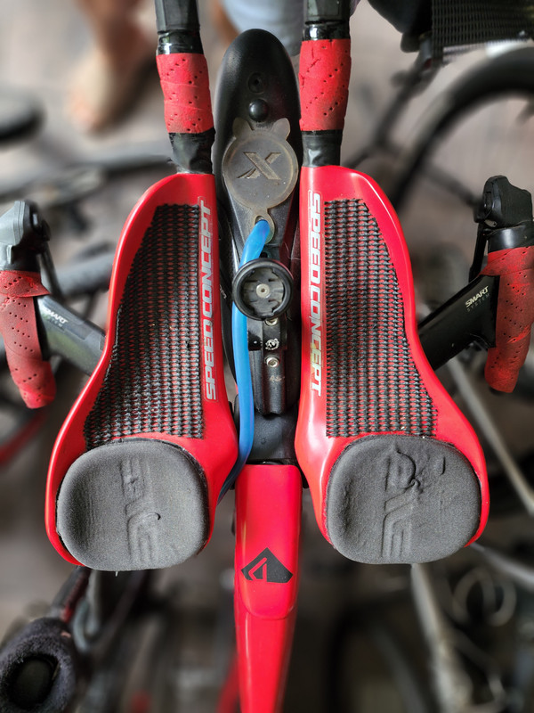

I mounted mine (Xlab Torpedo) under my aerobars. I like it better that the top area of my aerobars is free. Not sure of the aero penalty but i prefer it this way. I can refill my hydration from the top.
https://i.postimg.cc/QC2DzLvN/20220722-142613.jpg
https://i.postimg.cc/gJ2TqMSM/20220722-142558.jpghttps://i.postimg.cc/T3ZdsbMq/20220722-142545.jpg
