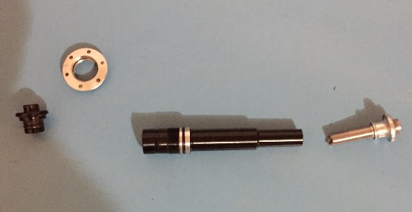

Rear hub was buzzing and vibrating while coasting at high speed. Oh right, time to clean it and lube it. The axle nut was stuck fast. Took all my might to remove it. But then the axle nut broke while putting it back together at moderate force compared to what it took to take it apart. It was probably already damaged. Broken right where the threads begin. Tried to remove the broken piece from inside the axle but it is stuck.
I need an axle and the axle nut. See picture.

Found it! Anyone order from this site? Is this legit? The price is extraordinarily steep.
https://www.mavicparts.com/products/mavic-ksyrium-sl-2004-2007-rear-axle-assembly-m40667
I could buy an entire new rear hub for that price and extract just the axle. But Mavic changed the Ksyrium hub design over the past 10 years, so no way to know if the axle would be the same… This for example looks wrong:
https://www.mavicparts.com/products/mavic-rear-axle-ksyrium-elite-2009-2011-996-862-01
So does this:
https://www.mavicparts.com/products/mavic-rear-axle-assembly-ksyrium-slr-r-sys-32999901
That site is legit. He’s been selling Mavic and Campy parts for years. He could probably tell you which one you need if you send in a picture of the broken one.
Thanks. I placed the order. $55 for an axle mumble grumble. These rims are GREAT. But the Mavic hubs leave much to be desired, plus are expensive to service and have hard to find parts. If anything happens again I’ll pay someone to lace a shimano hub up front and a powertap in the rear.
