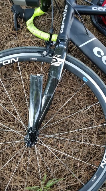

In a crash last night the fork on my 2008 Cervelo Soloist Team snapped in half. The right shifter got mangled and the derailleur hanger snapped.
I only bought the bike for $800 but I’ve upgraded the handlebars and wheels. I’ve been quite happy with it but I’ve never been on a disc road bike with wider tires.
Is it worth replacing the parts or is it time to have a funeral and bury this in the back yard?
(My own body sustained almost no injury, just some minor scrapes on the elbow. Another rider broke his shoulder, and the young dude that caused the mayhem suffered embarrassment and some pretty good road rash.)

So you need to replace a fork and one shifter to keep the 12 year old bike on the road. The newer handlebars and wheels can be moved to a new frame or sold.
So it really comes down to whether you really want to keep that bike for another few years, or fancy a new one, or and what life is left in the other components.
The chainrings, headset, and BB, have a finite lifespan - are they all in good shape or getting worn and nearing replacement time? (I left out the cassette and chain as they’re nearly consumables)
Are derailleurs, cables etc all in good shape?
I’d certainly be tempted to replace the bike if it was me, but if the rest of it is in good shape and you can get a fork and shifter for reasonable money, why not keep it going. Much better for the environment too!

check the frame out carefully, as well as the bars and the wheels. If what you’ve listed is the only damage, you can get that fixed / replaced for under $500 (probably less than that, but giving myself some wiggle room). If you’ve upgraded to carbon bars, then I would probably replace those anyway since you say that the crash mangled one of your shifters, it was clearly quite a bit of force to the shifter and bars. I prefer round aluminum bars myself, so they’re not expensive. Actually just waiting on a new bar with a more modern bend shape that I picked up for $35 to arrive.
If the damage is more extensive, or any sign of frame damage, then it’s new bike day.
Good call. The tape is toast anyways so I’ll remove all of it and inspect the bars pretty good.
I have a fork from a 2008 R3-SL that I am planning on selling but didn’t get around to posting it yet. Let me know if you are interested.

I think it’s probably less than $500, especially if you look for used parts. I think the Soloist team is aluminium, isn’t it? I wont’ be too concerned with it. I’d also check the bars, have seen a friend’s handle bar snap off just below the shifters while he was on the drops.
Unless you just want a new bike and are ok with the price, then go for it.

Anyways, I ordered a used Easton EC90 Aero fork and some used 10 speed Sram Red shifters. The shifters should be an upgrade and I guess the fork is a fork.
So while I cobble together used parts to keep a 12 year old bike on the road my son is getting race wheels for his MTB this year. Happy Fathers Day! He really ought to have my name as a sponsor on his jersey.
