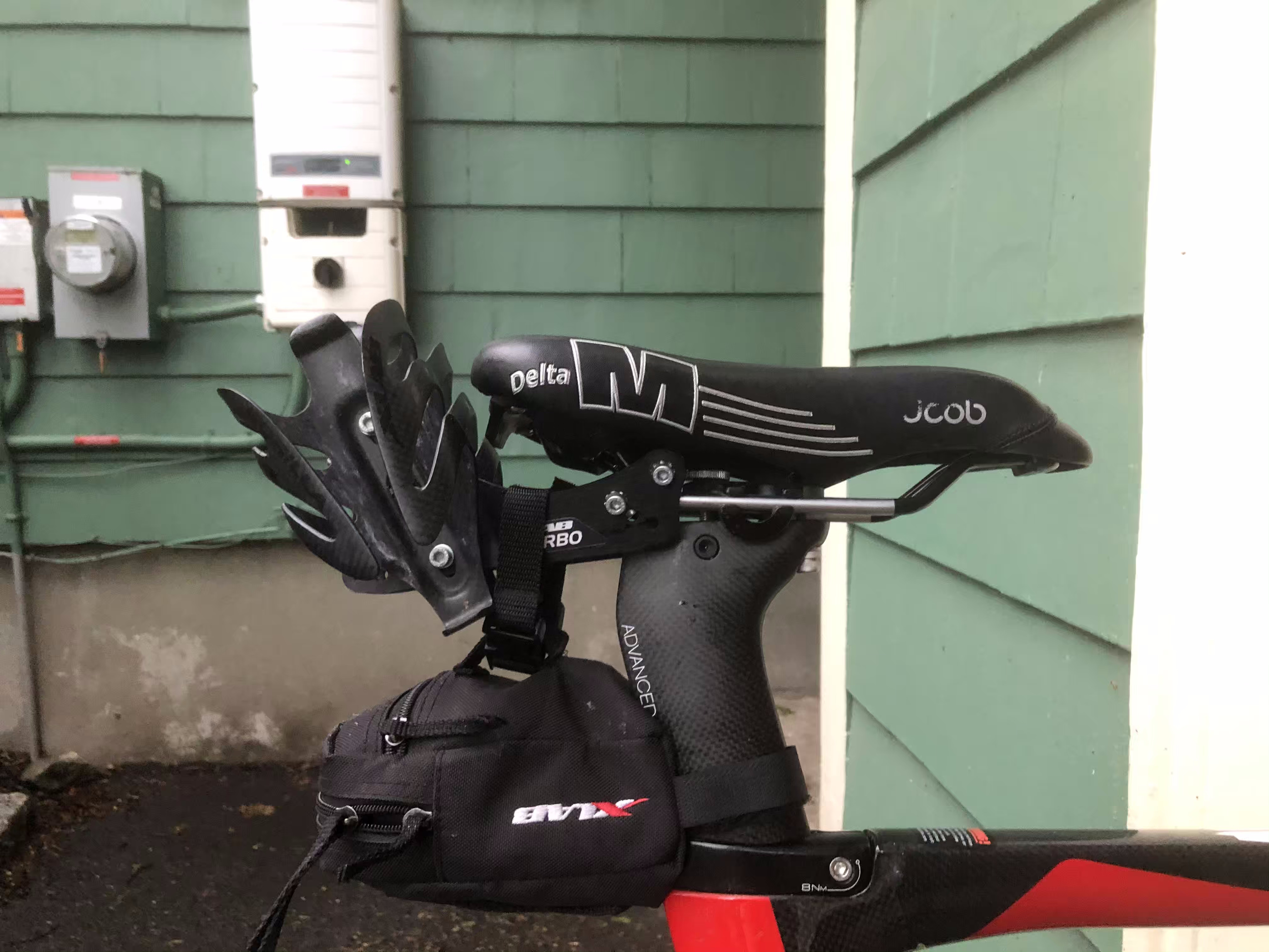

I installed a rear-mounted X-Lab Super Wing last fall.
I deliberately angled the cages on a modest diagonal–not straight up and down–because I was told that would mediate the tendency of bumps in the road to loosen the bottles.
Nonetheless–Once or twice on every big ride, a bottle comes out. I’m very careful to make sure they’re pushed all the way down into the cages. And losing the bottles doesn’t seem to correlate to the size of the bump I ride over–sometimes it’s after a big bump, but sometimes after very modest stuff. If I only fill the bottles 50%–keeping the center of gravity lower–that seems to reduce the problem, but doesn’t solve it completely.
Has anybody else had a problem like this? Any suggestions?

There are quite a few factors that come into play when a bottle launches. The cage that is used, the bottle that is used (couple factors here), the angle of the setup (especially cages), the actual mounting of the carrier onto the saddle rails, etc.
Just from what you wrote - we actually recommend athletes having a more vertical position so that the force is on the entire cage vs just half the cage. It is a bit of a goldilocks approach though - you want the bottle to stay in, but at the same time it has to be comfortable for you as well.
We are happy to look at your setup if you wanted to reach out to us :slight_smile:
