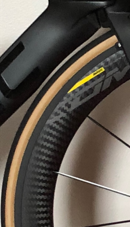

You can see in the picture the clearance with 25mm Vittoria G+.

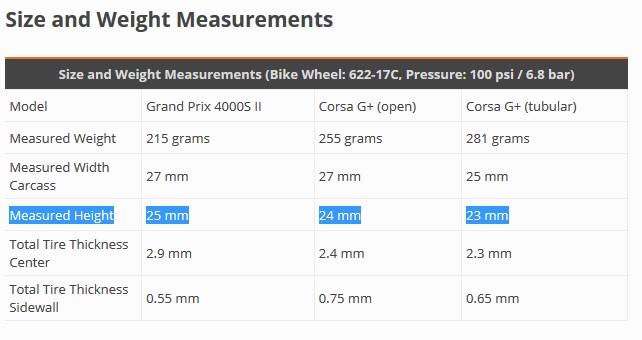

for the tire width/height issue, If you run tire comparisons from https://www.bicyclerollingresistance.com, it looks like bike height for the continental clincher is larger than other wheels, which explain why pro teams can run Vittoria 25 with no problems.
