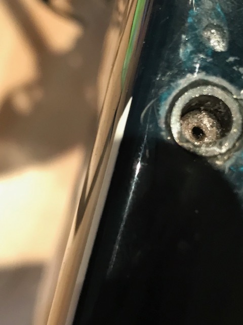

This is the size of the whole I’m working with (if the picture shows up)
Maybe I’m still barking up the wrong tree but it looks like a cable stop. Did the old cable have a ferrule there? When you removed the old cable did it have housing last that point in the picture? To me it looks like the housing is meant to stop there and bare cable is supposed to continue from there to wherever it attaches. Do you have a pic zoomed out to give context of where the hole is?
You are correct, but I’m just trying to insert the inner cable into that hole and it goes in about 2-3 inches and stops

This tool only works if there is a big enough hole to exit the cables. It utterly failed on my Cervelo p2c for the internal cable routing as the guide cables wouldn’t fit through the frame holes. OP will likely have the same problem given the tiny size of the hole (in what may be a stuck cable stop in the frame unless he can remove it as per the photo)
