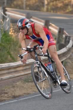

This is what I ran last year. I was happy with the setup (even though I went pretty slow…oops!). I definitely used the aerobars (I used full bars off my tri bike instead of my shorties). The wheels weren’t beaten up at all…plus they’re a lot lighter than anything else I have. I was also VERY happy to have my toe warmers on…SF is chilly!
http://i162.photobucket.com/albums/t276/mgreene11/alcatrazbike.jpg

Great info everyone – I am going to go with a gatorFL-style setup and I’ll use my Zipps. The aero helmet will be a nice touch to help keep my melon warm in that chilly SF air.
