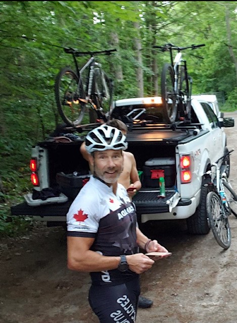

I built my own, I can put it on and off the truck in just a few min.
I basically made a Z plate the sits under the Tonneau cover and attached to the bed rail. IT just stays ion the truck and only sticks up about an inch. The cross bars attach to this plate with 4 thumb screws. I have it set up to hold 4 bikes at the moment and have some Kayak racks that clip on aswell.

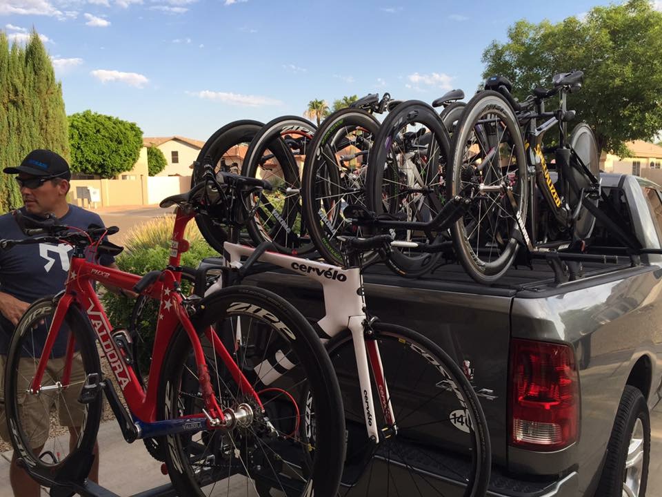

I installed a set of Yakima tracks on my bed, to the outside of the BAKFlip Tonneau and used standard Yakima mounts to put on the crossrails. Two crossrails have all the racks mounted to them, and the third has wheel holders. I have six wide on their now. Only five in the picture (if it uploads). I can unlock the rack from the mounts and lift it off myself, though it is a bit cumbersome solo. Then I just slip the covers over the mount attachment points when not in use. I use velcro strips between bike frames when going long distances to keep motion limited.
