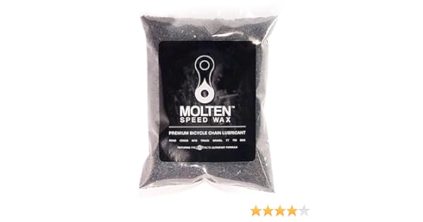

You need to clean all the petroleum crap off the chain before applying wax lubes. Otherwise you just get black road dirt goo balls.
Just get the Molten Speed wax and follow their cleaning instructions. I clean and wax the chain, use for a couple hundered miles and then switch over to Squirt. No more little grease turds on the carpet.

+1 on all the wax suggestions. Clean your chain and drivetrain really well with a degreaser and then use wax – melted wax like Molten speed wax will keep very clean. Squirt isn’t too bad, but not as clean as melted wax. I actually use melted wax on a new chain and then mostly Squirt in between because it’s faster/easier. You can additionally wipe down the chain gently/quickly when you get home and it should stay very clean.

Seriously, it IS all that. You will be shocked how amazingly clean you bike, hands, and workspace become, and you will completely ditch your degreaser (gasp)
