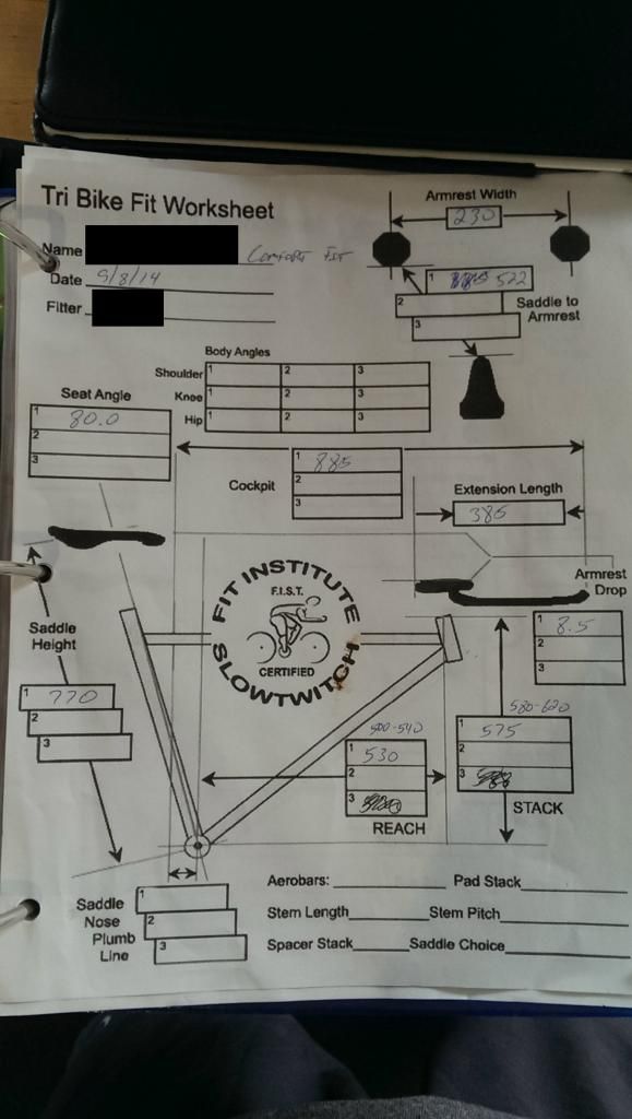

I would like to get some feedback to help understand the stack and reach numbers that were measured during a recent bike fit. My coach is a FIST certified fitter, and has several years of bike fitting experience. Several of us are scratching our heads to explain the numbers we measured. We even went back over it several times to make sure it wasn’t just an anomaly. This was a fitting for a tri/TT bike setup, done in advance of looking to buy a new tri bike so we could find the best bike for me. Here are the numbers we got:
Stack - 575mm
Reach - 530mm
These were measured with a seat angle of 80 deg. and a simulated 90mm stem length. He uses a Retul fit bike.
The stack number measured is not too far off from the “normal” range, but the reach number appears to be way off the chart. Even in some of the biggest frame sizes out there, it’s hard to find a bike with a reach measurement higher than 440 - 450.
I am a male, 6’ 1" tall and my torso is pretty long in proportion to the length of my legs. I also have above average flexibility (yay me!) and my coach has been working with me on flattening my back as opposed to riding with a rounded back position. The only explanation we can come up with to achieve that reach number is that a combination of all these factors are what is putting me in that category with a reach measurement anywhere from 500 - 540 mm.
I would like to hear feedback from anyone who might have any thoughts, suggestions, or if I need to provide more info? Thanks in advance.

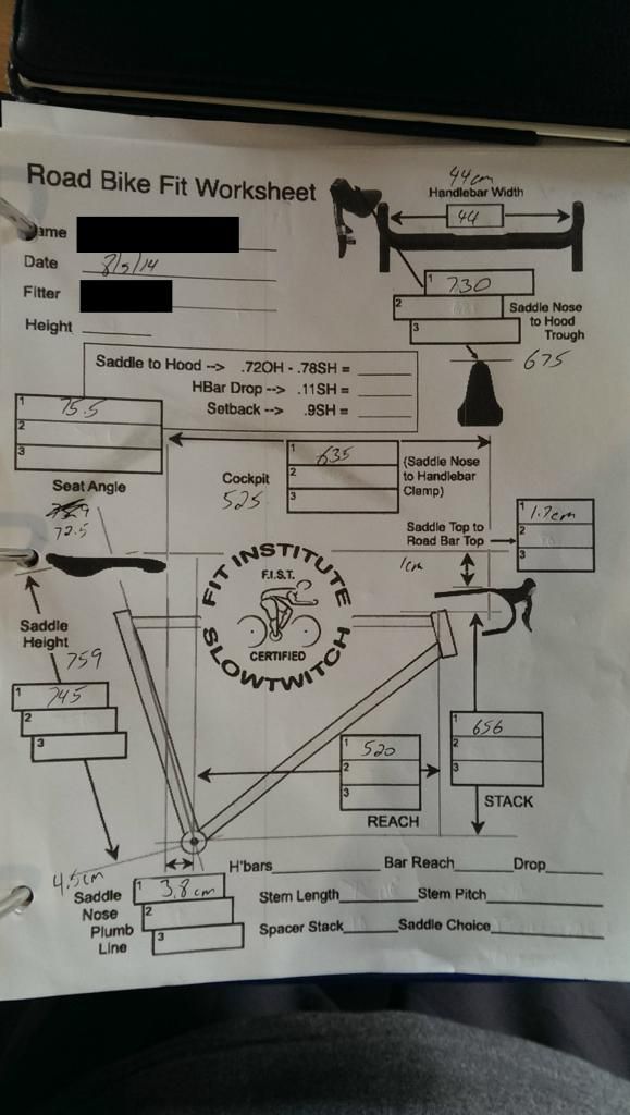

AndresLD - thanks again, I’m sure you are right I am likely misunderstanding the terminology. Here are links to the bike fit worksheets. One is for the Tri Bike fit I am referring to in this post, and the other is for a Road Bike fit I had about a month prior.
I’m including the Road Bike fit for reference only. I ride a 2012 Cannondale Synapse Carbon 5 size 58, which if I could do it all over might not be the best bike for me but it was my first bike and I didn’t get “pre-fit” for a road bike before I made the purchase. The posted stack and reach for that bike is 60.1cm stack x 39.6cm reach. I have a FSA Gossamer 130mm stem inverted on that bike, and it feels pretty comfortable to ride.
http://i194.photobucket.com/albums/z94/nitro_882/IMAG1068.jpg
http://i194.photobucket.com/albums/z94/nitro_882/IMAG1069.jpg
That stack just seems way off. I’m 6’-2" tall and I have a stack of 592mm and a reach of 435mm based on a Retul fit. You’re an inch shorter and have a stack of less than one inch shorter than mine but a reach of almost 4 inches more? Seems off to me. Maybe a typo and the reach is 430mm.
