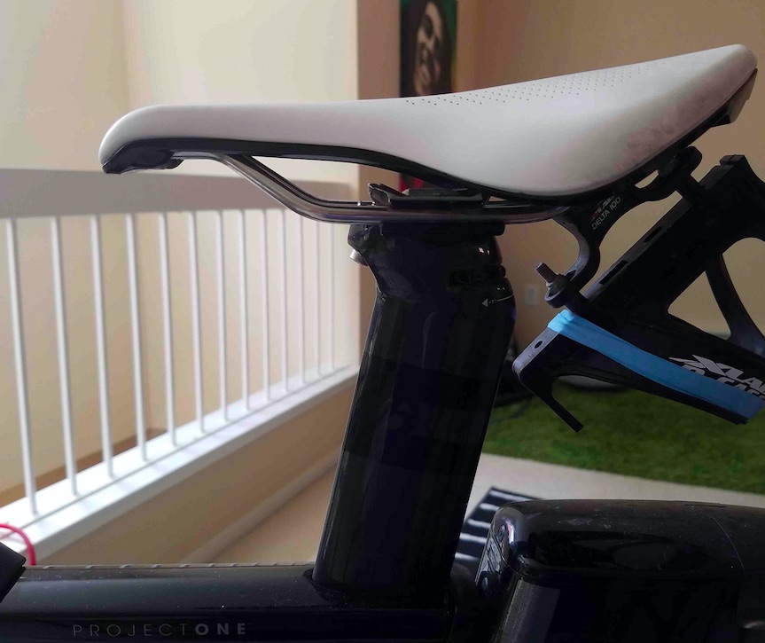

My saddle is almost parallel to the ground, a tiny bit angled forward. I could try leveling it, I guess but seems like this is more likely to upset the apple cart of the overall fit…
What kind of saddle do you have? Without seeing you in person, my first instinct is start by bringing the saddle nose up just a bit. If you have a seat post that allows for fine adjustment, a small board or book, and a digital level (smartphone apps will do), maybe tilt it up .3 to .5 degrees.
I tend to care more about the angle of the saddle where your ischial tuberosities (sit bones) are than the overall angle. You’re likely sliding (and, subsequently, feeling the load on the shoulders) because the part of the saddle where you are actually sitting is angled downward too much.

The saddle is Specialized Power and the post is the Bontrager one that comes with SC. I could try raising the tip up a smidge, sounds reasonable.
This is where I’d start.

Took it apart and tried to raise it as much as possible, but looks like it’s already all the way up. Seems like the only way to get the tip up would be by sliding the saddle on the rails, don’t want to do that just yet…
