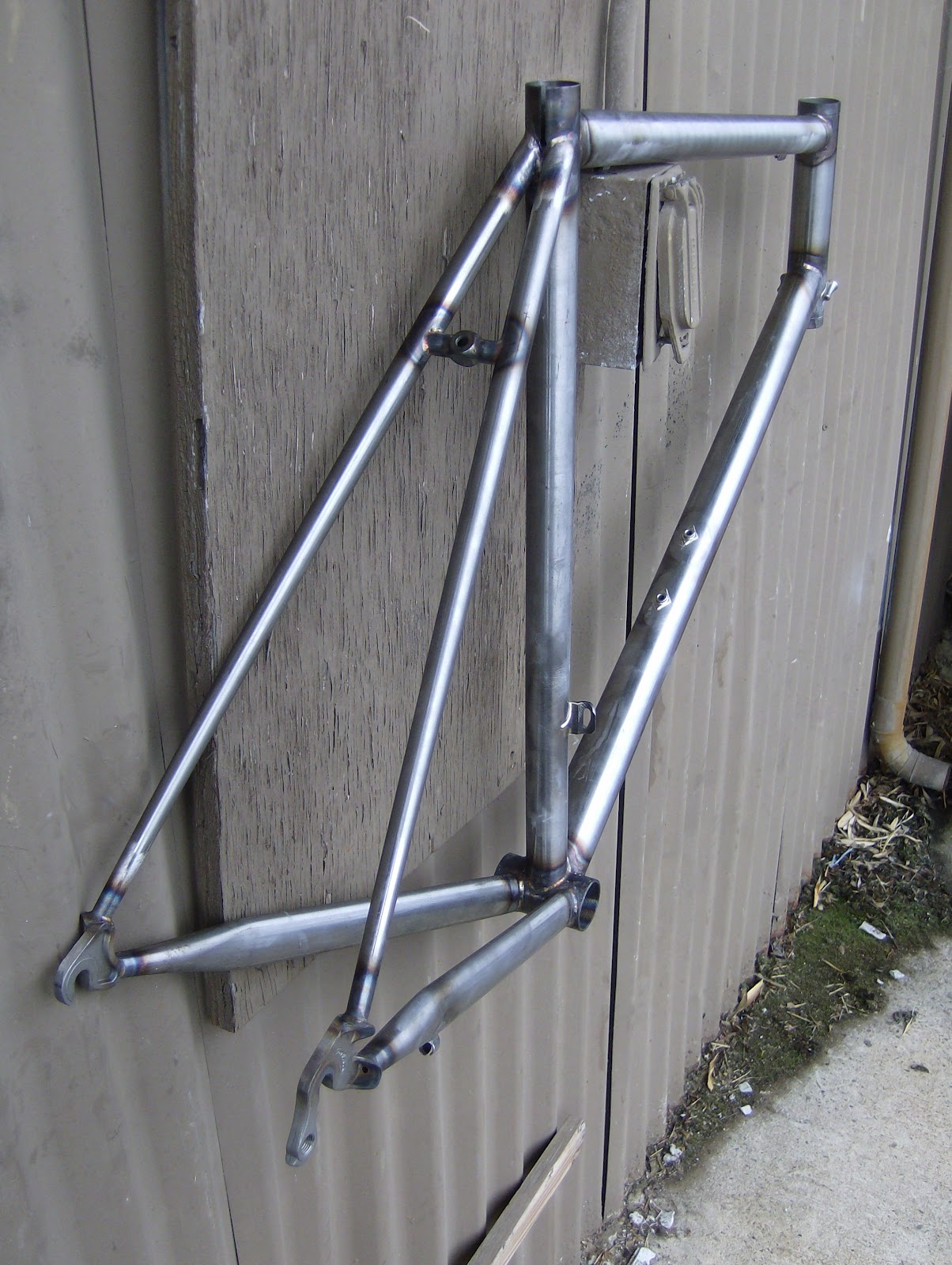

Seat stays started as “open” because they were made from two steel tubes, with a bridge brazed in to add some stiffness and mount the brake.
http://3.bp.blogspot.com/-ryhO39m0F4w/T5a7SI-7W3I/AAAAAAAAFpU/7pxOCU0ipV8/s1600/mavic+visit+006.JPG
Having the seat stays attach as high up as possible also yields the most rigid frame (with a more rigid design you can use lighter material and save weight).
When carbon forks & seat stays became popular, it was easier to bond in a carbon seat stay that attached to one tube behind the seat tube (thus the “closed” seat stays).
