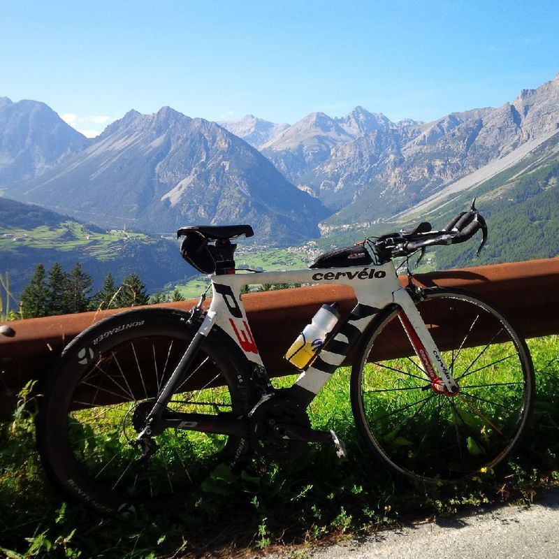

Here is the set up I used at 70.3 World’s modified for riding Stelvio and Gavia on race week. You see I have TT cowhorn bars with an up turn, and what I did for my Stelvio and Gavia rides was I rented an alloy surface front wheel (I brought both sets of brake pads) so that I could safely deal with the descents. This is what you see in the picture. For 70.3 WC’s with only one “not so technical” descent, I just went with the dual Bonetragers.
