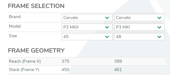

I see benscycle on ebay has some size 45 (650C) Cervelo P3 frames available. That and the premier tactical are the smallest carbon tri bikes ever made. Pretty much any other bike is likely to involve a compromised position.
Starting from frame is a great way to go for a petite rider as it means you can get everything right instead of dealing with oversized stock kit.
On the short end, I start with a fit first, get my list of options, and then shop. My last purchase, I actually found I was a good match for a widely available bike (a 48 P2/P3), which saved me some $.
Benscycle also has a new old stock (NOS) 650C P2 as well for a bit less money, those caught my eye recently while thinking about possibilities for my daughter. Interestingly, the reach for both 650C models is listed as 389, which is 8 mm longer than the current 700C 48 cm P2 & 3. Not sure why that should be as the 650C wheels should allow significantly shorter reach.

The geo changed for the 650 bike between generations
The first gen wasn’t really making the most of the wheel size for reach, just lowering the stack.
2nd gen better on both (in terms of being a smaller bike).
The XS speed concept was 370,468 so actually the same reach as the Cervelo 45 once stack normalised. You might need to grab one of the Cervelos to put in storage against the day her SC dies…
