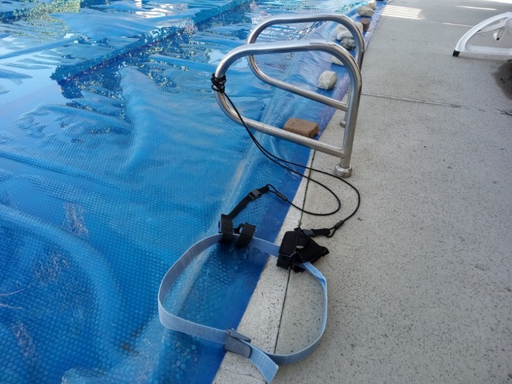

I guess everyone is different. I’d say the exact opposite about the attachment point. I tried my tether once which was designed to attach to feet/ankles and used it as designed, and I absolutely hated having it attached to my feet. It felt incredibly uncomfortable and awkward. Then I grabbed an old 2-in. wide scuba weight belt (sans weights, of course) and looped the feet and ankle loops to attach to the belt, positioning the loops on my backside for freestyle and breaststroke (I slide the loops around to the front for backstroke). That was a massive improvement in comfort and left my legs free to kick normally. I’ve had no problems whatsoever with legs sinking, but I’m a relatively decent swimmer and quite comfortable with technique. I’ve done a lot of time in the pool with this setup.

I understand how the tether is now connected to you (via waist belt).
But, more important, how/where exactly is the tether anchored to the ground or pool? To what object exactly? Below water level? At water level? Above water level? If above or below water level, by how much?
I have a well-anchored ladder at the side of the pool and loop the tether a few times around one of the ladder handles about a foot (.3 meters) above the water level just over the edge of the pool. This seems pretty ideal and keeps the cord from touching my legs.
