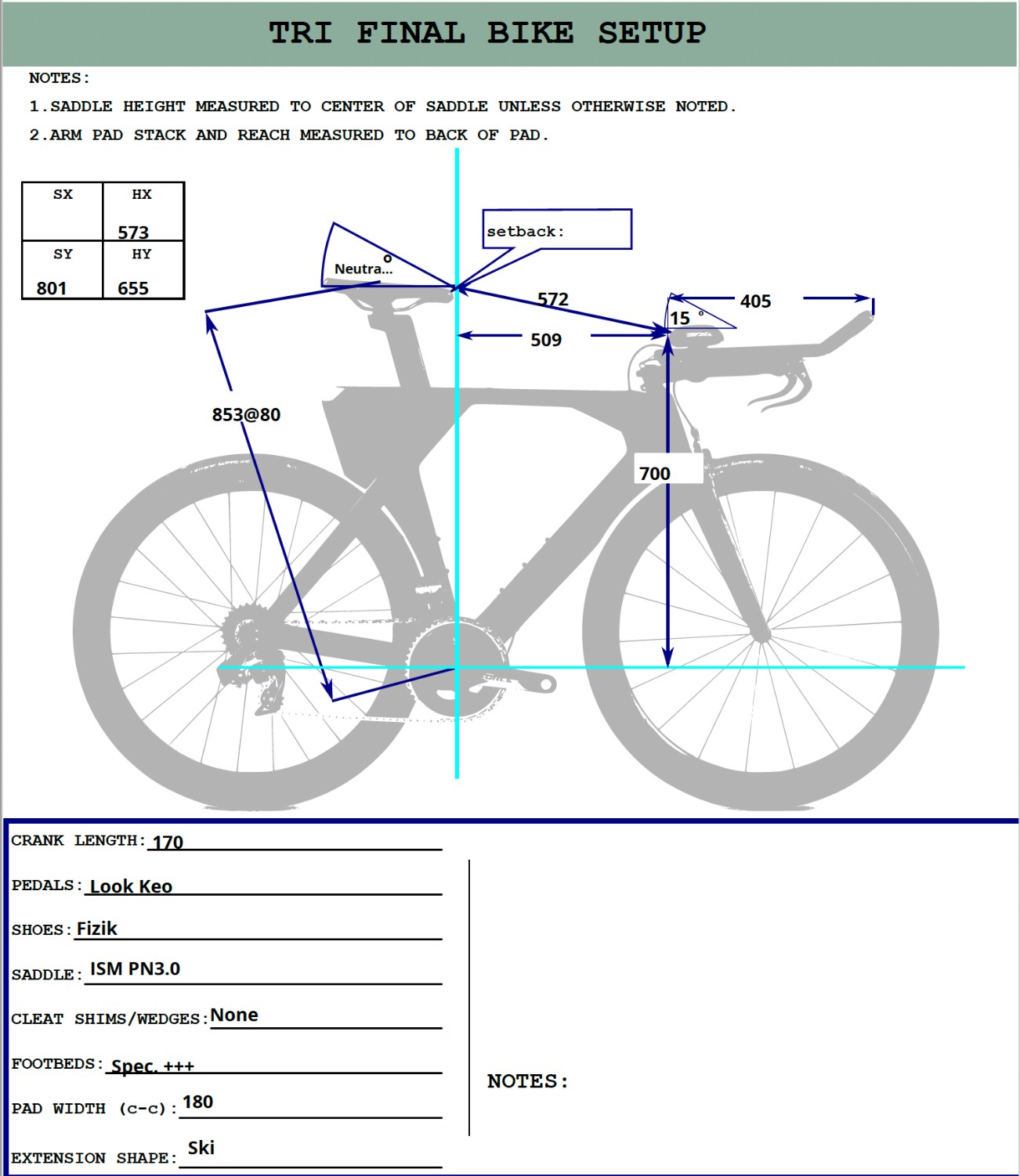

Fitting details below:
I have looked hard at Canyon (and almost pulled the trigger earlier in the year), but the horror stories of people getting parts would likely steer me towards a Cervelo or QR. FWIW, I have a Canyon Grizl and love it. The proprietary nature of the Speedmax does concern me though.
