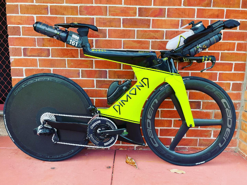

As someone that has had a Brilliant, Marquise and a Mogul Dimond I still remember the first day I rode my first one, the Brilliant down the road after finishing building it. I was looking for rough sections to run over as having come from a Shiv and never ridden a beam bike the contrast felt night and day the reduced road noise. Each to their own but it is subtle differences like a beamed bike, the difference between a spoked disk or a solid disk and the like as minor as it may be I’ve enjoyed. Check out the small amount the new Trek Madone seatpost hangs out the back of the frame to give aero road bikes that are renowned for a harsher ride a little more dampening and compliance.

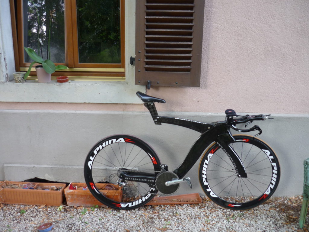

The Pearson Beam Bike:
My friend has a Pearson bike. Graeme Pearson was the first person I thought of to build me a custom mantis set of tri extensions before they came into vogue. He comes from New Zealand and just across the ditch as we call it in Australia, seems adventurous with what he likes to do in carbon and did me a custom set at a fraction of price you can buy a stock set now…
Off-topic…but what base bar is that Shambolic?

That front end is pretty dope. Have you tested whether there is any cost to that down tube bottle?
I’m assuming you mean the bottle on the underside of the tri bars? That was for an IM and I run three nutrition bottles so was about function but if not doing an IM I run an empty Xlab Torpedo in the hope it is a more aero shape. But no I’v done no testing.
