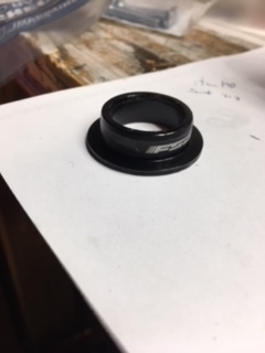

This the the BB with the 24mm spindle cups attached.

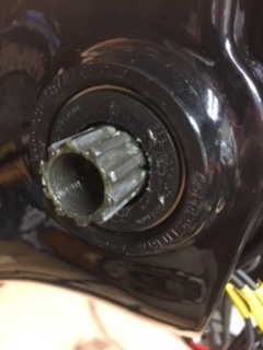

This the the Force GXP installed. You can kind of see the gap between the spindle and the BB cup. I could wiggle the crank, not a tight fit. The spindle needs to be a bit longer.
The 24mm reducer cup removed.
BB without the 24mm cups. Used a long screwdriver and hammer to pop them out. Came out pretty easy. The dimension is now 30mm. I think the BB30 Red crank is going to fit. It’s tight getting the crank through the bearing but works. Was looking at the Sram manual. Need some small spacers to use the crank on the BB386. Going to order some then see if the spindle on the Red crank is long enough.

Thanks for the great pictures. One thing to note is that “MegaExo” is basically Shimano spec (24mm spindle on both sides) and GXP is 24mm on the drive side and 22mm on the non-driveside. That’s why there’s a gap on that side. Your reducer’s hole is 2mm too big. The reducer set I linked a couple posts up would be the GXP specific one if you decide you are going with the GXP cranks on your build.
If you use your 30mm SRAM crank, being a tight fit in the 30mm bearing is right. Any shop should have a handful of spacers if you need them. I needed a couple mm on the drive side to center BB386 cranks on a BB386 frame.
