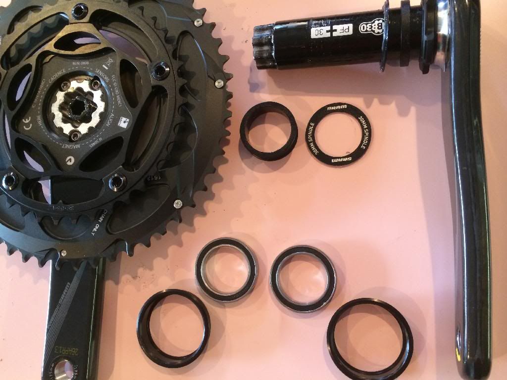

For those with a PF30 on a C’dale, my final setup was Drive side crank, the 12mm spacer, the black “30mm” dust cap, the BB30 cartridge bearing, then on the none drive side… the other bearings, then the other dust cap, a 6mm spacer, the adjusting nut device then the Non Drive side arm. The photo also shows the new bearings and the PF30 caps.
http://i1368.photobucket.com/albums/ag182/Hoodriverlife/Bike%20Projects/EE8A6D65-A8FB-437F-AD61-92181DD3D572_zpsnkncgu5e.jpg

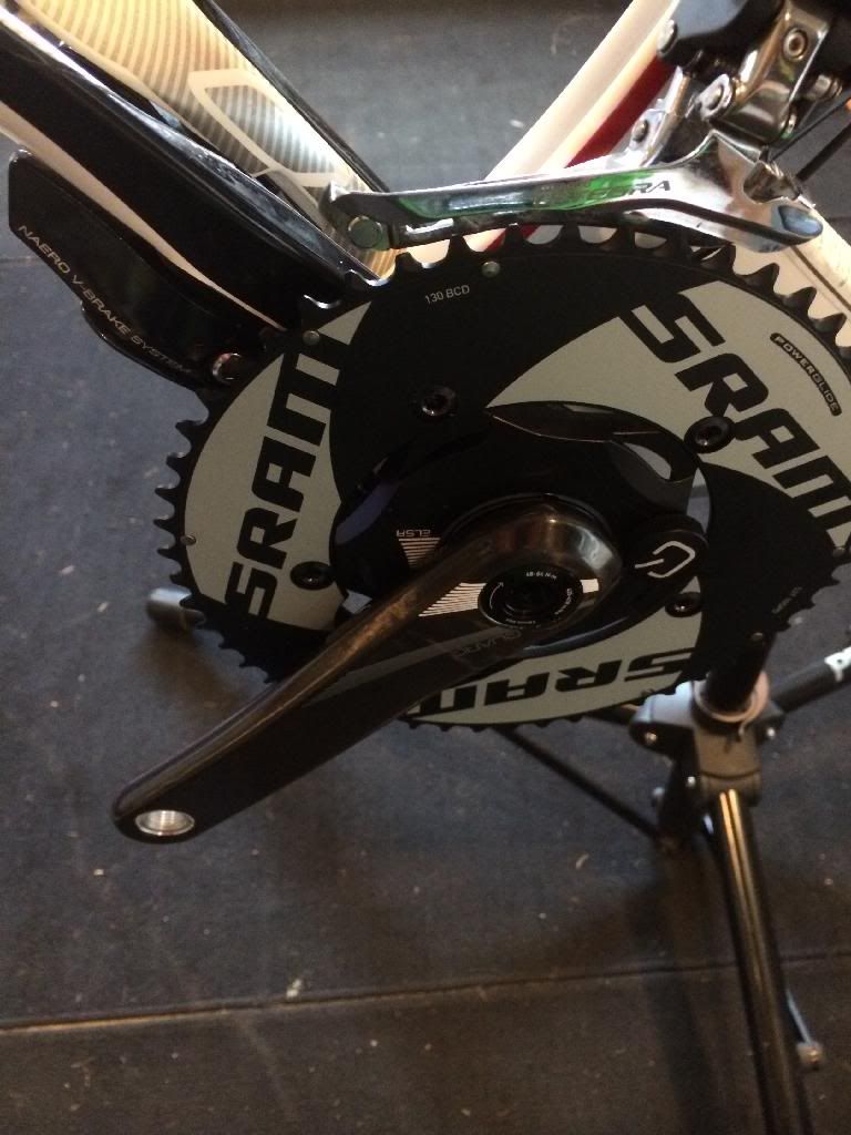

Installed!!
http://i1368.photobucket.com/albums/ag182/Hoodriverlife/Bike%20Projects/2F692AA4-F11B-43B7-BE55-32972B013A5A_zps2abxyvng.jpg

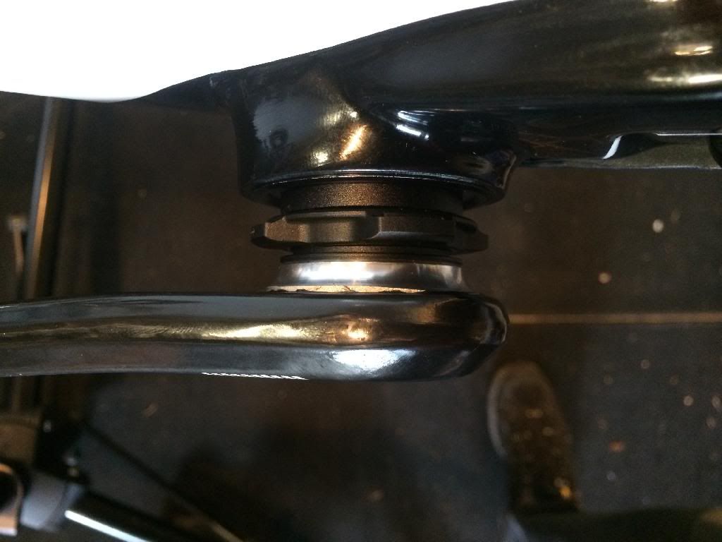

The ND side…
http://i1368.photobucket.com/albums/ag182/Hoodriverlife/Bike%20Projects/4705FE34-E5AB-4E70-93B1-6342D7639C60_zpsxrrscixx.jpg
