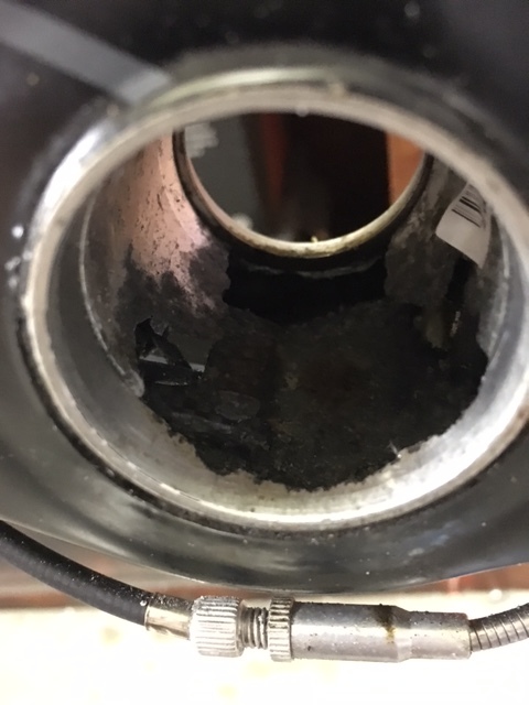

So here’s my dilemma. I presently am using the push in plastic bb30 to 24 for a shimano crank adapters on my 2011 shiv but recently discovered significant corrosion in the bb30 bearing housing/BB shell. See pic.
Would the BB30 Outboard Angular Contact BB for 24mm Cranks (Shimano) cited above be a good solution? Where the integrity of the Shiv’s BB factory inserted aluminum sleeve (for both bearing hold strength plus any tensile strength it adds to the frame’s BB shell) is compromised due to corrosion, would this threaded into adapter spanning the BB shell restore any of the potentially lost structural integrity to my BB while at the same time accommodate my shimano ultegra crank?
