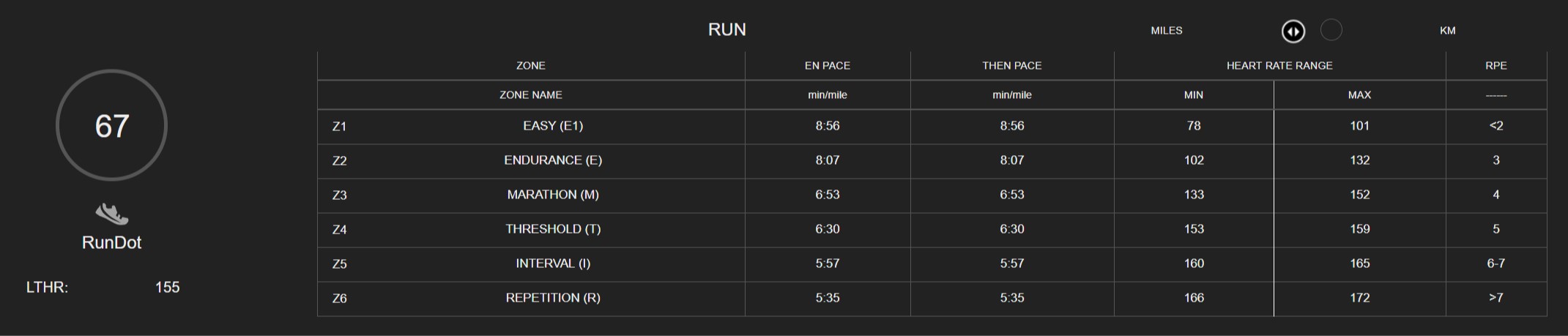

Here are my current run zones:

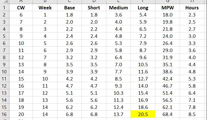

The Plan
I’ve got roughly 26 weeks for my Ironman training. Following the max 10% increase would generate the following plan:
Note: this would leave 10 weeks for race specific training (phase 2)?

Short (Recovery Jogs) @ 8:28-9:11
Medium (Easy Runs) @ 7:22-8:22
Long (Long Runs) @ 7:26-8:41

1) Too Much Volume
I am concerned that building up to near 70 miles per week will result in injury. I’ve only completed an average of about 12 miles per week over the last year, peaking at 35 miles. At what weekly volume should I cap off the build?
2) Volume Increase
How do I know when to increase the volume or maintain?
I realize the plan I provided increases at a 10% rate, which is aggressive. Some of the articles say that many weeks I shouldn’t increase the volume. I haven’t found info yet on how to make the decision on increasing volume.

How did you calculated your paces ?
I tried from the original BarryP post but the calculator was not available to me. Or did not understood how it work.
If the volume is getting excessive (and your plan would be excessive for me), I’d suggest tweaking the classic 1:2:3 BarryB proportions after a while.
So perhaps initially stick to 1:2:3 for short, medium, and long runs, but then, perhaps at week 15, hold the short and medium runs constant and continue to increase the long run distance.
I agree with this.
I also wouldn’t be too rigid on the paces. Barry P, to me anyways, is about safely building volume. If you feel good resist opening it up and going hard. Use those days to shed some fatigue. If you feel a bit rough, build into the run - you should loosen up and feel better after a few miles.
If you have some running background, I would probably peak at week #13 in your chart below, and then alternate a few weeks where you just increase the long run to 19/20 miles. Since you’re going to be biking a ton (hopefully), I would also recommend cutting it to 5 days per week and skipping a short run. I did this a few years ago and it helped keep my sanity along with all of the other training and didn’t affect run performance.
So week 13 would look like
5.6 - 11.3 - 5.6 - 11.3 - 16.9
And then week 14 would be
5.6 - 11.3 - 5.6 - 11.3 - 19
Not sure where your bike fitness is, but it’s way more important to execute a successful marathon.
You could also increase less than 10% during the base period so you hit your peak around week 22-23 rather than week 14.
I’ve been running on this plan or a plan very similar to it since 2008 when I was riddled with injury. I’ll leave you with a few ideas.
  1. Don’t get so hung up on reaching that 20 mile long run distance in the structure of the entire week. You will still need to balance swim/bike.
  2. Don’t be afraid to add another run on your long run day. You can accomplish a lot by breaking that long run into two more manageable run’s every other week or every two weeks.
  3. I’ve seen several athletes KQ on the BP plan an only run 45-55 miles per week within the given 1:2:3 structure.
Good luck and don’t over do it.
Generally, it works out to about 10k race pace + 1:30 - 2:00. Easy/Long run pace = 10k+1:30…recovery jog = 10K+2:00. But, the key point is to never do anything that compromises your ability to come back and do it again tomorrow. So, if you wake up the next day, and think “Whew! I’m a bit sore from that, not sure I’m ready to run again today.” (but, you probably have that thought it French)…Then you are better off to slow down a little more.
As Desert Dude has said many times, “Its easy to run too fast, it’s hard to run too slow.” Whenever, I’m running and I feel bad about how slow I’m running I remind myself of this quote.
I also tend to run more by HR. The correct pace should be around high-z1 to low-z2. I tend to start low and let it slowly drift to low-z2 by the end of the run. But, that is caveated by all the usual HR based training limitations. Nevertheless, when in doubt slow down.

Hello -
I can’t address all your questions right now, but I do want to quickly talk about your volume.
After 10-15 years of no running, you averaged 2.8 miles per week in 2017 and 9.6 miles per week in 2018.
I think your chart that has you going from 18 miles per week to 68 miles per week in 16 weeks is too optimistic. I’m not saying you can’t do it. I just wouldn’t create a plan like that with the high probability of not reaching your targets.
When building plans, I always try to make reasonable targets with some cushion, and if I am able to surpass that I do.
That said, you are doing the right thing by posting your plan and getting feedback! So kudos on that.
My advice would be to increase your volume much slower, especially since 2017 doesn’t really count as any running, and 2018 is hardly a solid base for this type of volume.
I would recommend something closer to 15 miles per week for week 1 and 40 miles per week for week 16.
40 miles per week is no joke and would still be a huge success.
If your body feels good, by all means make adjustments to your plan as you go and scaled those numbers up a bit.

OP: This plan sounds like way too much running for an Ironman. Sure, the run is supremely important, but you already have a solid run ability, if not necessarily a base at the moment. Your run will bounce back relatively quickly and I would be afraid that building to 70 mile weeks would take away too much time from critical bike training. You would be better served by building on the bike, and capping the run closer to 40-45 miles. Especially for a race that is known to have a rather challenging bike course.
Exactly my thoughts written out much more elegantly! I was really wondering what a reasonable volume progression would be on a year to year basis.
60 miles per week seems too aggressive, and it crossed my mind that 40-50 miles per week would perhaps be a good “plateau” to re-evaluate.
Here is one more piece of advice that works for me, and I consider myself a BarryP success.
Run 6 days a week. Listen to your body and adjust the distance of your runs as needed. You will be surprised what volume you can handle if you play it smart.

Thanks for the feedback everyone, it seems the feedback so far has addressed questions #1 and #2!!!
Overall, the BarryP program is about running by feel and feeling GOOD while running.
I will plateau around 40-50 miles and start to incorporate the “ultra long” run every other week.
Based upon how my body is handling this, I will tweak the weekly mileage.

Just to be sure, are you talking in min/km or in min/miles ?
Currently I’m running mostly around the lower half of z2, around MaxFat, so I shall not be very far.

#3: Don’t. You don’t have enough run base to justify any tempo—its only a risk of causing injury. Bike more…and just friggin’ run easy.
#4: Just friggin’ run easy. Count it all. Its all warm-up / cool-down / running.
#5: Um…no 5kTT (well, you can go do a race if you want). But, the answer is your training paces will be getting faster. Your run training pace will be your run race-pace…if you are lucky and pace the bike right.
Being old and slow, recent to running, I’m very careful with volume increase, total volume, and intensity. And choice of shoes / orthotics. And when some pain is coming, slowing down. Solving pains sources one by one (the last two being knees, as I was not using them “straight” enough apparently).
Ah…sorry, I knew you were French—I should have converted. Those are min / MILE. Adjust for metric accordingly.
