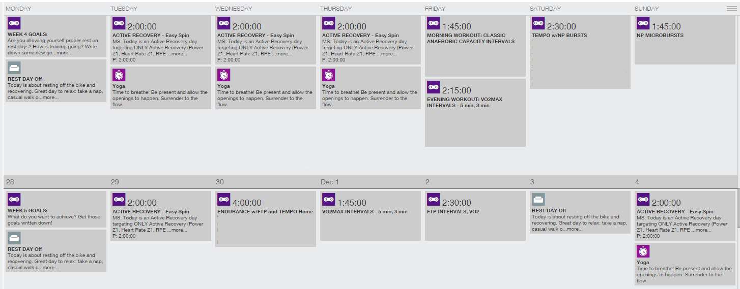

used a 3 day advanced block training program from hunter allen through training peaks. It was a good program but after four weeks I ended up using it as the base template and fitting the 3 day blocks into my schedule as I could manage. It probably isn’t the best plan for someone who can’t be flexible with their week schedule. Some weeks would be M-T-W ON, with 3 days rest/recovery work and then the block would start again on a Sunday. For me there were some weeks that I had to insert extra rest or L2 training so I could make the blocks fit my week schedule. I think this sometimes leads to non-optimal stress loading, too much rest.
Since I used a canned program I can’t speak much to the actual composition of the blocks and what type of work should be day 1,2,3. My recall is that generally it got shorter/harder the farther into the block, opposite of what you suggest.
My key learnings:
· When you accept the program you’ll surprise yourself how much hard work you can do in a block.· Going deep with the training stress is amazing but mentally taxing. Be prepared to be really really tired.· Recovery is paramount and recovery rides must be Z1 or lowest Z2.· Diet and sleep need to be on point.· Fixing your workout schedule to a “week” is not the best way to train and recover.· It is difficult to race during the block plan due to the rotating schedule. I had to bump blocks for mini-tapers going a race 2x during the plan. When I did this I used the race as the first day of the next block.
Here is a sample of week 4-5 with the workout details redacted. I highly recommend hunter allens plans at training peaks as he has several block plans to choose from.
edit: updated picture for better resolution
My key learnings:
I agree with most of your points but that plan is puzzling with its 2 hr Recovery workouts. Why 2 hours? Is that really recovery? I do the occasional 2hr easy spin in recovery weeks but the vast majority of recovery workouts are ~1hr, <30TSS. Of the pro cyclists I train and race with I don’t know many who use a 2hr recovery workout as standard procedure…maybe Hunter has some different ideas?
