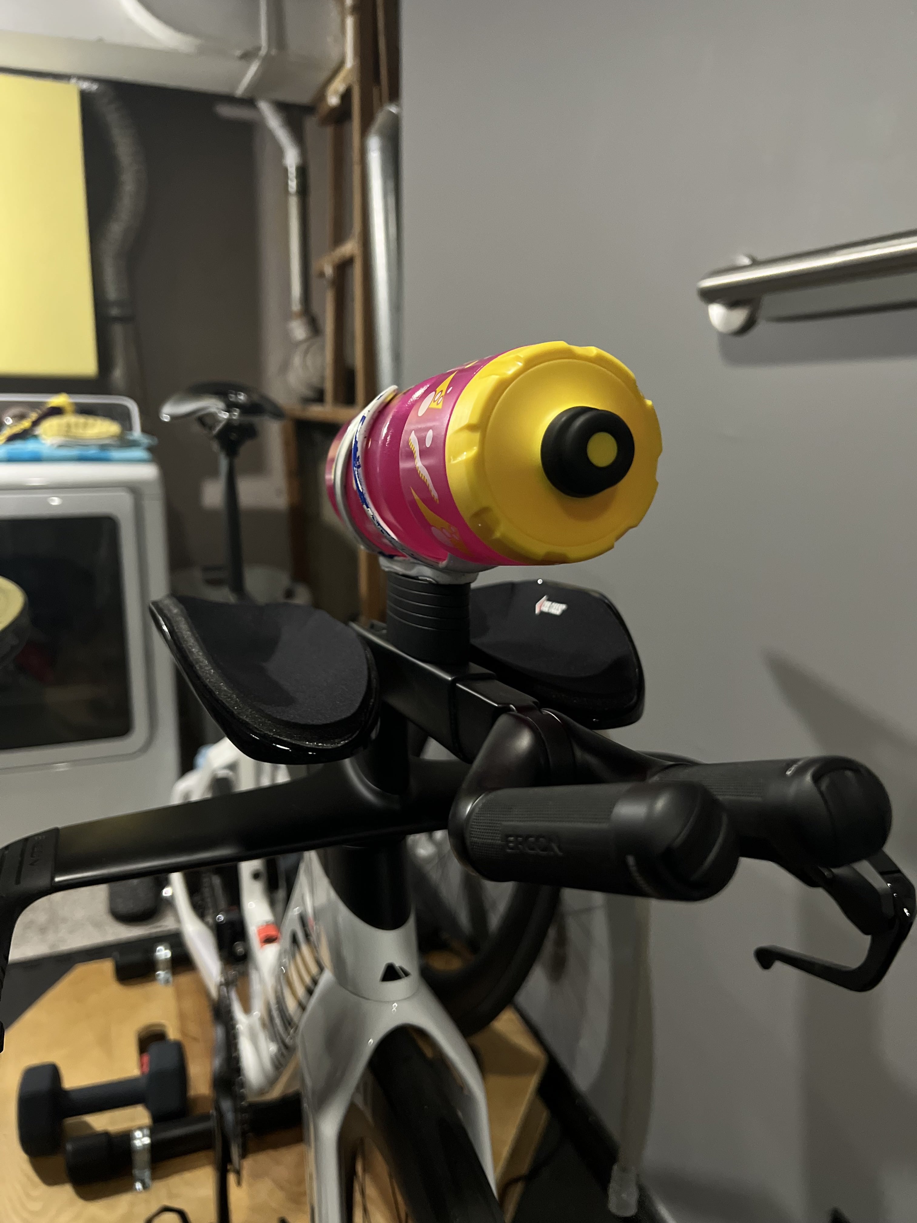

I used some extra spacers from the monobar and longer screws and just screwed them into the part that holds the extension into the monobar. Doesn’t fit right into the bottle holes because they’re too close together and I’m sure it’s not a great idea but so far seems to work okay. I also 3d printed a spacer to shove in there and give some more support.
Can get some more detailed pics later if anyone wants something specific let me know.
I originally wanted to print something but didn’t have time before my race so if anyone else has a file I’d love to have a copy.

Not sure where you think I drilled anything. I simply used the two existing holes in the monobar that attach the extension to the main part. Sounds like your number two above only instead of using the tower portion by using the screws further up the bar. My only concern with using the screws on the tower themselves is they seem to have some more weight bearing usage and that scares me a bit. I do like the idea of using their Garmin mount though so I may consider this as well. I have the canyon Garmin mount and may try drilling it out to attach bigger screws to it. The idea of using the quarter turn mount atttached to a bottle cage might be better as long as it’s strong enough. I’ll try it over the weekend and try and post a video here.

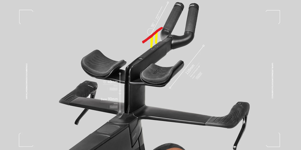

No worries, hopefully this makes it more clear, I took this photo off the canyon website and drew yellow where a longer screw is and red where the bottle cage goes. The space is not correct spacing for bottle cage screws but I’m using one of these cages(https://www.rei.com/product/171468/rei-co-op-junction-water-bottle-cage) from REI that has a longer open channel in the middle so I was just able to screw it in the big open part. I then used some of the spare monobar tower spacers and just clamped them between for some support, I put the pins in there as well so they’re all aligned as well. I am a little nervous about the usage long term just due to the fact that it wasn’t meant to be holding any weight, but it is on a non critical part of the bar so I’m hoping it is alright. Eventually I would like to do something different that is more foolproof.
