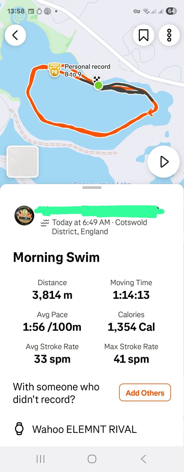

See my swim in OW this morning. Pace close to 2 mins, i didn’t start my watch until after warmup and stopped before c/d. It is not about sighting, as the watch measuted the distance in whatever direction. Not about the wetsuit, which is comfortable. How is this possible? Can it be the gps on my wahoo is so off?
You’re going in a circle. So part of it that when you turn, you lose some momentum. Do you also have a safety buoy? That slows you down a bit as well.

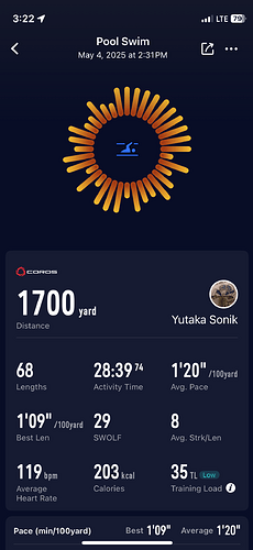

My last pool swim before StG

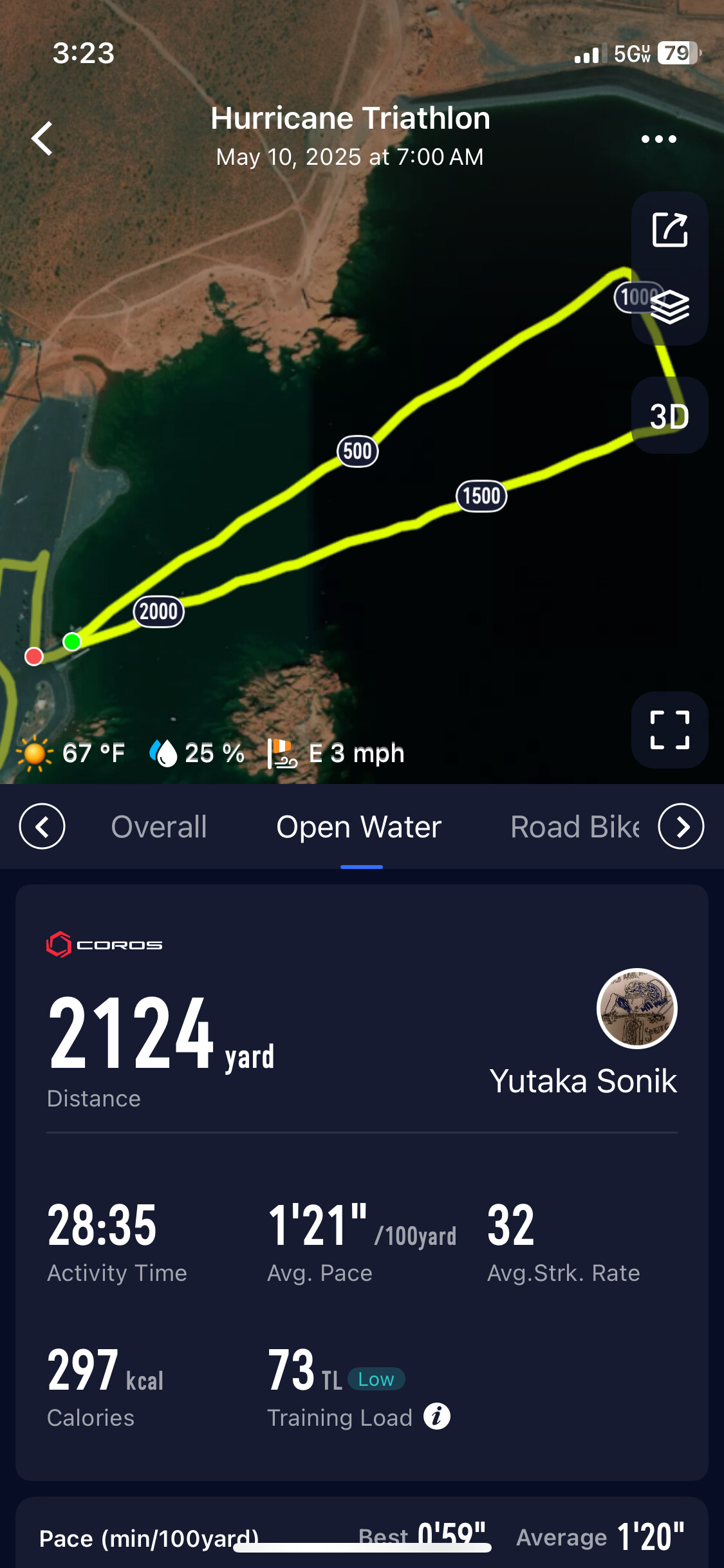

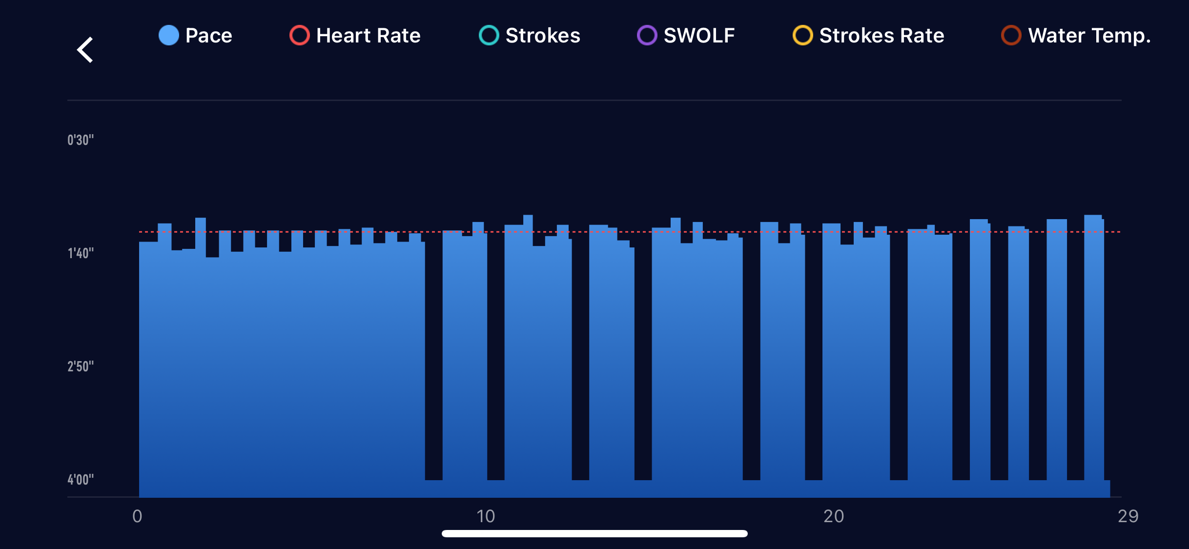

Just as FYI, your watch was really off on that last pool swim as 1700 yd in 28:39 is 1:41/100 yd, not 1:20. And with an avg of 1:41, it is highly unlikely that your best 100 was 1:09. Interestingly, your watch seems accurate on the St George swim since 2124 yd in 28:35 is 1:21/100. It is moderately amazing that you went 20 sec/100 faster on race day; were you really tired on the 1700 swim and then rested a bunch before the race???
For pace determination, the watch not does take the rest data into account - here’s what the set looked like:
