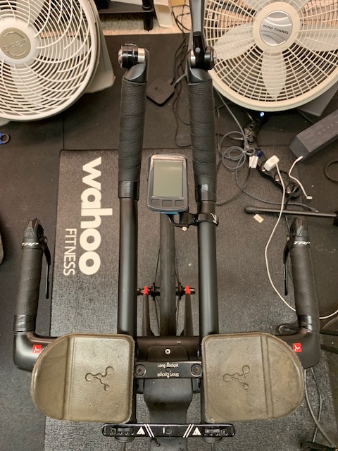

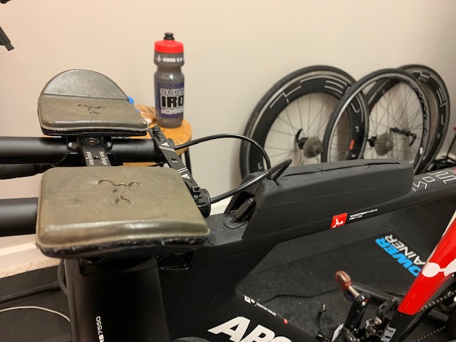

The PD FC-35 actually should work pretty well with the cockpit setup. I used a PD Aero HC for a few years and it has a similar mounting system. The bracket connecting the pads/extensions would get in the way of the GPS mount on the HC, so I couldn’t move it very far back, but it looks like the FC-35 has the GPS mount on the front so it shouldn’t interfere. I’ve since changed to a more simple setup so I can just swap bottles at aid stations and added a simple PD mounting bracket at the bottom of my extensions, and now I can just attach any BTA bottle cage directly to it (using both brackets). The Specialized Rib Cage has worked great and holds both a standard bottle and the Gatorade endurance bottles pretty well.
I also bought a bento box directly from Argon (used on the E-119 and some other models) and it still fit the bosses on my top tube. Pretty sure it’s the same as one of the Torhans models. One of these days I’m going to try and 3D print a new stem cap that fits flush to the front of the box. Depending on the race i’ll run a Crono CX on the downtube and a single bottle BTS.
